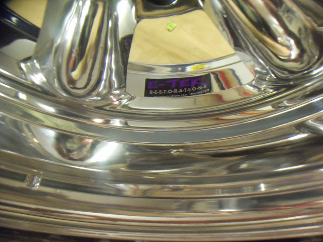

Well look what FINALLY showed up!! :rocker:
It pains me to say it (but in a good way) they were definitely worth the wait WOW - talk about your vehicular BLING! :bowdown:
Here's some teasers, just until I get them installed tomorrow:

How long did you have to wait for those wheels? I can usually get American Racing like those in two days, or I can get knockoff that are American Eagles, next day in any size and offset.
I was actually going to go with that style of wheel on momma's Olds. They are now what Cragars were back in the day. But I'm kicking it around about going with some other style of wheel as everyone and their brother and sister runs that style around here. They look great, and I love the style, but when you go to a car show, 75% of the people there have those on their car.:sad: Don't take it the wrong way......they will definitely set the '40 off and they look great, but the first show he goes to, he have the same wheels as the person to either side of him.

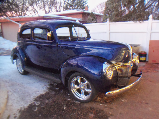

Now that the 40 got it's new shoes....
It was time for it's first tentative steps... en route to getting its interior, exhaust and final tuning taken care of:
As a token of our shared interest in his now beautified 40 Ford rod, the owner gave me the original banjo steering wheel from his 40 to use on my Model-T Runabout Rod build....as well as a bag of home made wild-meat Farmer Sausage!

Finally some outdoor pics :thumbup: The '40 is looking good setting outside. Nice job on it.
It does look like it could stand a little wider meat on the rear, but looking good non-the-less. :thumbup::thumbup:
I don't know how things are north of the border, but around here and even in my podunk little town, American Racing caps get stolen quite a bit. They interchange with the cheaper American Eagle caps. And American Eagle sells an identical wheel but about half the price of the American Racing. People will steal and swap out caps, then ******** somebody when they sell the wheels or car with wheels.
You might tell the owner to invest in some tamperproof stainless flathead screws. Those would be the ones that have a pin sticking up in the middle of the hex, and the hex wrench has a hole in the end to clear the pin. A normal hex wrench can't fit the hex because of the pin.
And again...it looks good. Enjoy the little bit of space you now gained in the garage for a week or two :lol:
Oh and BTW......I think you deserve a YOU **** for the Banjo wheel :thumbup::thumbup:

Thanks guys. Im thrilled with the 40, but moreso that the owner is happy. Its really not nearly finished and will be back for parts that have to go on after upholstery, plus whatever shows up on the shake downs. As well it'll go back to the painter to address a few issues before a final cut and buff.
That photo makes the back wheels look smaller than in person, but we do have some work to do back there to finish the set up. Owner has lowering blocks for it which will bring it down another 2.5", plus, he may set the axle back a bit to center them better in the well.

Very nice work! I admire you're dedication. It is not easy to finish a complete car for a customer. Especially doing it alone. Great job! Thanks for sharing all of this.

E-Tek....does the owner know any history on the car, or was he the one that had it repaired before?
The reason I ask is that where the door is fitting at the front fenders, are the front fenders original to the car or are they possibly repops? I know the hinges play a huge part in it, but it those are repopped front fenders, they may just have issues of their own too.
When I was redoing my truck, I had to put a new front fender on and it was a *************. It took me one complete day to just get a fender to fit up correctly. I had less time than that putting in cab corners and finishing them off.
If it were ma, I'd go over the front with a fine toothed comb and make sure there is no accident damage evident in the front that may give you some trouble on down the road.
What do the rest of the rocker panels look like, inside and the back side?
