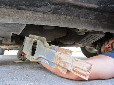

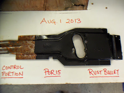

1 year Update: POR15 vs RUST BULLET "Real World RUST PAINT Test"
July 31st, 2014 - the test plate I attached to the underside of my van was removed 364 days later, after having travelled approximately 45,000kms across the salted, sanded and gritty roads of Saskatchewan Canada, where temperatures ranged from +38C/110F to -40C/-40F and with constant speeds of up to 125kph/80mph for up to 5 hours at a stretch. While by no means a Scientific Study, it serves the purpose of showing how these paints perform in "real-world" conditions, exceeding the abuse they would be exposed to in wheel wells, frames, suspension components, trailers and other exposed metal surfaces.

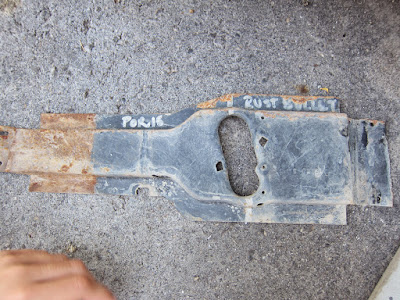

Removing the plate:
And here it is, the even rustier control section is on the Left, the POR15 and Rust Bullet painted sections on the Right. The test peice and paints are still coated in a film of salt and road-grime.

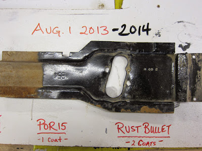

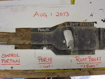

Photo A - After an initial (dry) wipedown, the plate was placed on the original labelled board -
Photo B - Plate was flipped over, showing the underside
after being cleaned with a water-dampened paper towel -
Discussion -
Both paints where largely intact and protective of the base metal underneath, suffering no major adhesion issues. However, both paints suffered minor damage and removal along the leading edge, an area subjected to direct contact from grit, stones, salt and more (top edge in top photo A, bottom edge in photo B).The uncoated section continued to rust, whereas only small sections of the leading edges of the coated sections did so. After wiping with a wet paper towel the sheen/shiny surface was returned and in good shape.
For comparison, here is the plate 1 year ago, when it was first prepared and painted with the two rust paints:
Overall impressions:
As promised by the manufacturers, both single-stage, air-cured epoxy paints did a very good job of protecting the metal substrate overall and sealing/protecting the vast majority of the coated surfaces. As mentioned above, both paints did suffer what I would term as a "minor" adhesion issue - damage/removal atthe leading edge, which would have taken a large amount of abuse from road debri and harsh weather conditions.
