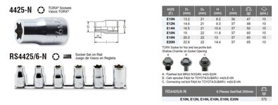

Some folks have mentioned the different chamfer on some tools. There is actually a “low profile“ E torx. I have not encountered these (seems to be mostly on Japanese products) but if you need it, some manufacturers offer separate tools for the purpose. Here KoKen.
