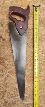

Hi All,
I occasionally see the mention of Disston Hand Saws on GJ here & there, so I thought I would start an official thread dedicated to early Disston saws. I'm not really a hand saw buff, but when I'm out on a tool hunt I know enough about them to recognize an early model. A couple years ago I got lucky & ran into this beauty. I bought it for a few reasons. The early handle construction, the split nuts, the older Disston medallion (sons not mentioned yet) & the little nib on the top of the blade at the end. According to the Disstonian Institute, the medallion dates 1860. There's just one thing I'm not sure of. Instead of the blade being marked Disston, it has an English Hallmark & is stamped "M. Hargreave Sheffield Warranted Cast Steel." The blade measures 26" long. I read on Disston's website that from 1840-1855 Disston used/brought over English blades until he started making his own steel. I guess during that time English steel was known to be superior. Any Disston buffs out there that can shed some light on this??

Nice looking saw. I'd say it was a Hargreaves saw that has had a Disston medallion (maybe a whole handle) added to it, as as-far-as-I-know there is no direct connection between the two firms which operated in different countries. Early Disston made saws followed the style of English saws, but the blades were stamped with his own name and Disston was not known to re-badge English stamped saw blades
13,398
Scary way to verify this is to pull the handle off, and see if you have multiple penetrations for saw nuts. Scary cuz you may break the nuts, which would be a tragedy.
I personally would leave the mystery.

I do know from taking it apart once after I got it that there are only one set of holes. Don't know if I want to risk it again. Apparently Disston did acquire tools & machinery when who he worked for went out of business. Compensation for back pay. I'm guessing these tools would have been to make these in the "English" way. He even imported workers from the Sheffield district. Question is, where did the blades on his first saws come from until he made his own in 1855? So could it be possible he used Hargreave blades until he could make his own steel in 1855? He had the tools to make the rest of the saw. Having the English Sheffield connection was to his favor. Any thoughts on this theory??

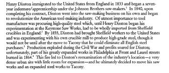

I found another interesting article about Disston's early history. He brought in all his steel from Sheffield until he started making his own in 1855. Even then, he didn't stop importing from Sheffield completely until he moved his saw works to Tacony in the 1870's due to the fire that almost destroyed everything in 1864. I just wander in the first years of his business, until he got his process down, if he may have used his Sheffield connections to his advantage. I've been looking online & I cannot find another "W. Hargreaves" stamp on a saw like mine? I see a Hargreaves & Smith Co. They mostly did knives & cutlery. This company was started though by William Hargreaves. It would be nice to see a pic of an 1840's Disston saw & it's markings.

I lucked out at the thrift store yesterday. I found an old handsaw for $5. When I saw the handle & the "nib" on the blade....I knew I found something good. It was in pretty bad shape. The blade was rusted with some pitting & the brass medallion was unreadable. I had no choice but to sand the blade to try & get some of the pitting out. Below are the after pics. I may still clean the blade some more, but I'm satisfied with it for now. The handle is a work of art! According to the medallion it could date to the 1870's? It also has a no. 7 stamped into the blade??
13,398
1896-1917 Is more likely in my opinion. Before that they were sunken medallions. The last generation prior looks like some were sunk. The nut shape make me think later, but I've been wrong before
The 7 should be teeth count, or correctly, points per inch. Start counting at the point, to the last point.

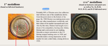

(Teeth per inch starts at the gullet.)
According to the Distonian Institute the medallion dates to 1878-1888. Pic below. It also looks like the next medallion too that goes to 1917? Did Diston make handles like this one into the 1900's? The bottom lip on the handle I always thought was an indicator of saws from the 1800's?

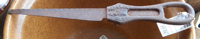

I only knew what it was because I found one in an "antique mall" several weeks go, but their asking price seemed a bit stiff.
Unfortunately, the Braid, highlighted here between the red marks, is not present on yours. Somehow I trimmed off the 1896-1917 from this image.
The lip is called a Lambs Tongue. If you go to the The Quick Glance…..Saws page, this nut pattern was used on the 7 & 8, not D7 & D8, and used to 1928 or 1918, depending. Following the links will give you more details
