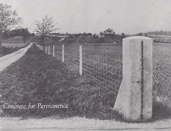

My grandmother's old farm had fence posts like these
Solid concrete. They were around long after the fences weren't.
