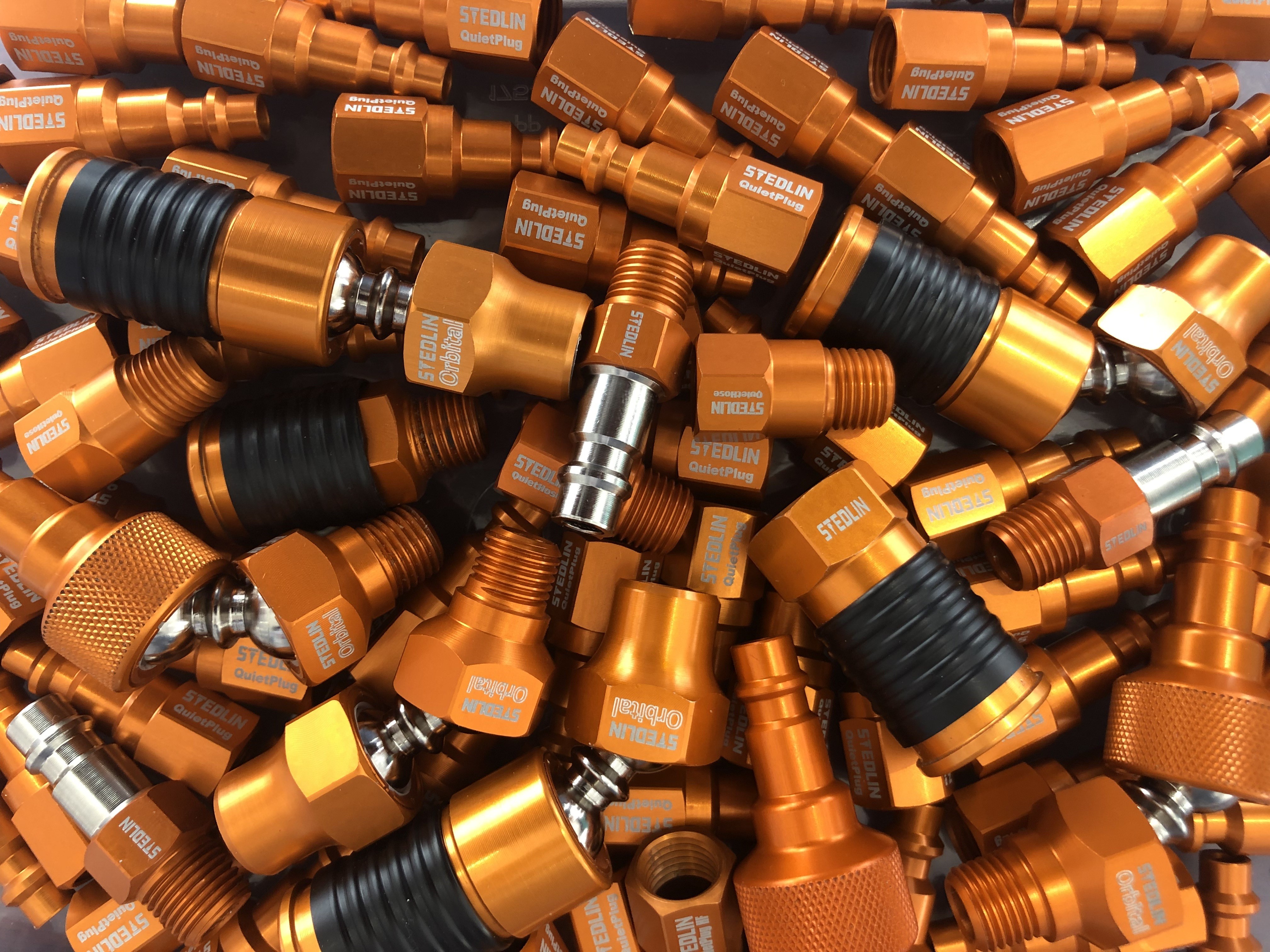

Recently I got a case of the ol tennis elbow and got a taste of what my future holds in terms of the loss of strength. Anyway I noticed that inserting air fittings is now more difficult. Aside from removing all the pressure from the line and then cranking the regulator back up once everything is attached I figure the only option is to look for some new couplers.
A while back I've seen the Stedlin posts on here and thought that I would go that way but when I went to order a few I saw their website down. There's another post on here about whether they are in business or not, I called that number but couldn't hear whomever was on the other end due to the amount of background noise. Thinking that perhaps they were on the production floor I called it again later to not get an answer. Based on that I'm thinking it's a no go.
Prevost seems to be another brand mentioned quite often but unless I am wrong it's only really designed to make the decoupling process go easier. I've had good success with traditional Milton fittings in the past but again inserting the item into a coupler was a bear. As I'm looking for something that will make the coupling easier (and hopefully decoupling also) I thought I'd post and see if there is anything out there that I may be missing. As background I only am looking for something for personal use, this isn't something for my profession or a production shop.

You can buy Stedlin stuff right on Amazon. I've done just that for many of my Stedlin couplers, plugs, swivels, etc.
If easy insertion is your goal, Stedlin is the way to go and nothing else comes close. I've done a lot of testing (and posted many videos here) mostly related to flow, but every time I'm connecting and disconnecting plugs during testing, I'm reminded just how much more pleasant it is to use the Stedlin fittings.

Stedlin for the win! I was worried that their aluminum construction wouldn't hold up, that they'd get crushed. I babied them at first. Now, I'm back to bull-whipping with my air lines, and I never have a problem. OK, the anodizing fades over the years, and my new fittings stand out from the old. I just ordered fitting from amazon last month and they showed up. Not sure what is going on at Sterling, I used to call and chat with the founder's wife (who seemed to run the paperwork side ion the business). Support Sterling.

I went down the Prevost road and one of them started leaking in less than a year. Switched to Stedlin and couldn’t be happier, even put them on the airlines at the day job and they are living up to the abuse that the shop monkeys are giving them.
