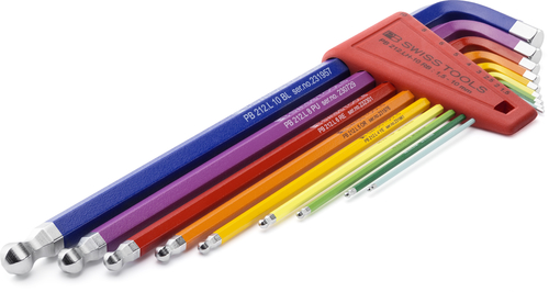

What I cannot understand is how Wiha, Wera, and PB Swiss can manufacture straight hex keys but Bondhus and Eklind cannot.
-I'm going to suggest this as a possible reason. The hex stock is coiled at the mill that gets fed into the stamping presses. This would create an embedded stress or pre-conditioned curvature to the stock. What is standard procedure for almost any stock coming off a coil (flat or otherwise) is to go through a device that straightens the stock, thereby removing most of the curvature. It's SOP for wire, flat, and bar stock whether it's a stamping press or a 4-slide. Eklind used to use them on every press when I was there and a banana shaped key was an indicator that the die-setter didn't do his job. I believe that this is the source of the problem, it takes some time and knowledge to set a straightener up. Some die-setters may be skipping the process entirely, haven't set the device correctly, or management has decided to eliminate the process they don't understand for faster set-up times. Hard to say. I suppose it's even possible for the stock to have so much internal stress it can't all be removed. The curvature from stress appears after heat treating. It can be unpredictable and unnoticed before heat treating. Example of straightener below

Sneak peak into PB Swiss production, video is in English language:
Kind regards,
Olli
-Well that was an interesting video. They work off straight bar stock and not a coil, have multiple extra operations, several stations where people are needed, and a mix of robotics and humans. It's no wonder they're so expensive by comparison to other brands. Thanks for posting this, I found it entertaining.
YesIHaveAHammer
Jun 1, 2025
970
At 1:03 with the rod in the lathe making the ball end, it seems they're rotating both the rod and the tool in a synchronised pattern to preserve the hex shape so it doesn't become round like a doorknob.
I was surprised at 0:35 to see the guy sitting there feeding rods into the machine and pressing a pedal to cut it. Likewise the printing of the holders at 4:20 and then filling the holders with the keys. The rest of the process is very automated with no human handling of individual wrenches aside from quality control (crookedness check, sizing check). I guess it's a matter of cost of automation vs. a person.
Being in one of the most expensive countries in the world can't help either.
-Yes, it appears that they are. This is the process that was developed for ball drivers at Eklind, but a different cutter head and insert was used. The process had been around for some time but nobody had applied it to ball driver hex keys. Bondhus didn't use it, they relied on an opposing broach process. I was rather involved with the project and I've posted about it in other threads.
-That was how Eklind did it too, Howard Eklind was told by some of his confidants that hex stock couldn't be run off a coil so 10-12 foot lengths were advanced into the press by hand. A few of us proved that you could run hex stock off a coil and that those claiming it couldn't happen didn't know what they were talking about.
-Some of the processes they use have a baked-in level of human vs. automation. They certainly have more steps in the entire process.
That's bizarre. I used to work for a company that made essentially all of McMaster-Carr's hex stand-offs (like for electronics or whatever). They had Eubama rotary transfer machines and ran hex coil stock on them. The machines had integrated straightener rollers and hydraulic shears that fed hex chunks into the inner workings of the machine. They'd be doing that since at least the mid 80s.

Rods vs. coils aside, why not automate the feed of rods to hit the length stop and trigger the cut?
Baked in in what sense? That they used to do it a certain way and it's difficult to change now?
-Automation is the purpose of feeding the press from a coil. You can't just go fully automated with every aspect of manufacturing. Turning a machine on and just letting it go is a recipe for disaster to occur. A lot of manufacturing has been using devices (prox sensors, tonnage monitors, buckle detect, part out screens, IR, vision verification, etc.) to verify things are going as they should but the cost/practicality of those devices comes into play. Eklind basically used a 3 step method for "L" keys once the die has been set.
1) Set the coil
2) Feed the coil
3) Run the press on "continuous" per the SPM you decided.
PB Swiss, for better or worse, has a lot more steps involved for the product they've decided on. Could PB fully automate the entire process? Perhaps but at what cost for ROI? There's more involved than this but I wanted to be brief.
-Every time a person has to touch, transfer, load/unload, or use compressed air on the product is what I'm getting at. There's a few times in that video where you don't see a person but one was there before, during, or after the footage was taken. The extra steps PB has decided to take mean a person has to facilitate that process whether you see one or not. They do make use of robotics but not all steps use one. The Swiss are not haphazard about how they do things and every step was examined, evaluated, and decided beforehand. They have a clear reason for the product they make and how it's made. Your questions are valid and ok to ask. Unless I see the costs and tour the factory I'm not qualified to criticize their methods. Nor is anybody else qualified that's an armchair quarterback.
