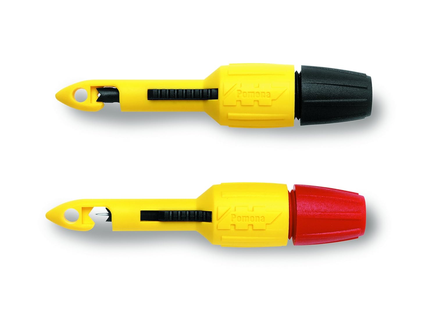

The BEST alligator clips (that slip on 4mm banana plugs) are Mueller BU-60. The insulated boots are sold separately (second page). The have many other different styles from small to booster cable size. They also sell fully insulated alligator clips.
Yes, they cost more and you are NOT going to find them at your auto parts or big box store. I get mine from Mouser.com.
Pomona 6405
are the best wire piecing probes

I'm not a fan of piercing wire insulation in automotive applications. It can cause invisible corrosion which is difficult to find.
