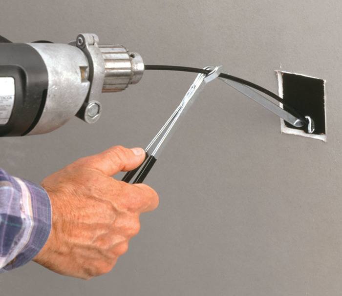

Google Versibit.
You can get a placement tool to help control it
