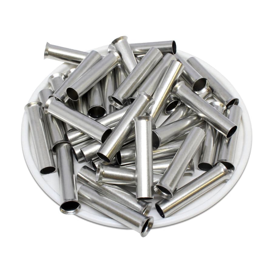

I didn't know what these were. I'm doing a project with a Victron MultiPlus-II 48/3000, building a bug-out trailer.
The Victron has a crappy clamp system for AC input and output and requires ferrules with stranded wire. Finding the right size (length), uninsulated, and right gauge, I've had to spend about $50 to get AWG sizes for these little boogers.
My question is - I HATE crimping things. I don't mind doing it, but I don't think crimps are not as reliable as solder. So I've soldered these to 8 AWG copper (stranded).
Am I doing it wrong?

In a splice, sure. Under a screw terminal as the OP shows, solder is ABSOLUTELY NOT acceptable. The solder will cold flow under the screw, releasing the compression over time.
Yes. For starters, bootlace fittings in those cord connectors aren't buying you much (I'll come back to that).
As to crimping bootlace ferrules meant to be used on stranded wire under screw terminals, I get that you want an uninsulated ferrule, because the insulated ferrules either aren't big enough for rubber insulation, or are too big to fit into the holes in that plastic. But you can easily buy a super cheap insulated ferrule kit, and press the ferrule into the plastic insulator. One little squeeze and it falls through, and viola, you have an uninsulated ferrule. Toss out the plastic, and you've saved a bundle.
As for the right size ferrules, again, you've got it wrong. You want a ferrule that's the same length as the wire strip length gauge. For that power inlet, it's probably 1/2". This $20 ferrule AND crimper kit has ferrules that are plenty long for the job. In most cases, I find myself trimming the ferrule length after crimping, because they're easy to cut back when they're too long.
As for crimping, bootlace ferrules do not require high pressure crimps that cold-flow the copper together inside into an oxygen sealed package. They don't work like a typical electrical crimp, so if you find yourself using regular crimping tools on them, I see your frustration. What you want is a 6-sided tool (my link is to a 4-jaw; more on that below) that crushes the ferrule into a tightly packed with copper dimpled square (or hex) that doesn't fall off the wire. After that, the screw terminal exerts the final pressure to compress everything into that oxygen tight zone, and the ferrule provides tension under the screw to keep all the strands together.
There are 4-sided and 6-sided versions of these, but since I tend to use these in smaller sizes that generally fit into square holes, I prefer the 4-sided crimper, because it allows me to pack the maximum amount of copper under a small screw (think green terminal blocks).
phoenix-contact-pluggable-terminal-blocks-pre-printed-with-numbered-positions-200.jpg
These terminal blocks have a screw that closes a clamp which pinches the square between the top and bottom.
In your application with round holes, these cord connector fittings are designed to accept fine stranded wire, so the screw pulls a saddle against a plate, compressing the pack of strands together. Much like this connector where the wires do not go directly under the screw:
That saddle usually doesn't have a flat bottom, so a square bootlace crimp will get kind of crushed by it, but more importantly, that style connector isn't really helped by bootlace ferrules. I don't think they'll hurt, and they can make clean assembly easier, but I don't see much help from a bootlace here.

I guess my experience seeing so many "crimped" fittings in other people's electrical work (mainly 12V DC) which have been ****.. Course, most of those are > 10 AWG and not made with a real crimper.
I have never had a solder joint fail personally. I tend to solder and heat shrink everything DC power. Everything. Even GM Weatherpack, I solder and crimp.
Never seen ferrules like this. What does the device look like that the wire is going into?
Not screw in. Some sort of spring loaded deal with a pressure release. Not a fan of this connection type.
I think I have it close, Victron specifies 3/4" stripped wire, which is 19 mm, so I'm 6 mm over. I'll trim, that's no problem.
Thank you. Let me confirm that my crimping tools support this AWG and are 6-sided. I believe they do. Any objection to crimp AND solder?

This. Ferrules are a metric thing. To get a perfect match to awg, you have to get specific ferrules and a different crimper
These fit perfectly for stranded AWG and I mean perfectly. I got one strand of wire that I had to re-work, but no problem. For $25/set, darn straight they should fit.
I need to open my tool box on crimpers, gotta see what's in there. This is a 30A input that I'm running 8AWG wire, less than 10 feet to the inverter.

Link to what terminals you bought?
Sure. 25mm, 6AWG:
Yea, I was off on that $35 per AWG shipped..
The issue is you can't get them in this length typically. This seems to be what the guys using stranded wire with Victron recommend if they aren't going to "hack it.

That's a bag of 250pcs for $35....
You could have bought them individually for $0.74 or less from digikey.
Panduit F84-25-7
Weidmuller 9004150000

Ferrules are spec'd for wire guage and pin length. (also insulated, non-insulated, singles/duallies.)
The pin length is determined by the depth that the receiving component is spec'd for.
Then the conductor strip length is determined by the pin length.
