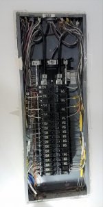

Guys, I have the wierdest thing going on with the lights in my garage and attached office. Any ideas on what's happening? Here's the deal:
1) LED Can lights in my office started randomly turning on and off a couple days ago. They are all on one switch and breaker about 12 in total. Turned the switch off and on and it stopped. Has not happened again until today.
2) This afternoon I was in the garage and some of the overheads started doing the same thing. The are not LED but halogen. I looked into the office and could see the LED can lights doing it again also. It went on for a few minutes and then stopped on it's own.
3) This evening I was changing out the garage door wall controllers and it happened again. The left and right bay lights are on different breakers as well as the office. This time I got it on video. See the link below. The video that's 3:38 is the one with all the action, the others has a little, but I was mainly flipping switches trying to see if they affected the lights:
https://photos.app.goo.gl/Kf8MoP5nUykDhh7G7
What in the wide world of sports is going on?? the halogens emit a frequency that causes static on the radio, could they also be messing with the lights? Breakers never got hot or tripped. I've had this garage and configuration for 3 years and this is the first time something like this has happened.
What do you guys think is causing this? Should I call Ghost Busters?

Check to see if all those circuits are fed from the same main hot leg in the breaker panel. If they are, it's possible the lug at the top of the panel for that leg is loose, or there could be a loose connection somewhere upstream of that between your house and the utility's transformer.

Yeah, pretty much any time you see flickering, especially if they’re LEDs, it’s a pretty good bet to start with checking the quality/tightness of your power connections at critical junctions.
If you just recently put in a new switch, it’s usually a good place to start by checking whether there is a history in complaints RE: that switch model and LED lights, especially if dimmable.

Maybe a voltmeter on those lines to see if 120v is steady or fluctuates?

I found a similar problem in a panel with my thermal camera. Instead of the hot leg, it was a screw holding the neutral bar down to a copper bus that connected the two neural bars. The neutral was fed from the right side, and the bar on the left had the bad connection. Most circuits on the left had low draws and still worked, but one exhaust fan wasn’t working.

You have a wiring issue for sure. The highbays are more tolerant of it because they have a driver in there that helps mitigate the effect. You're going to need to check all the connections on black, white and ground, but since they ALL seem to be doing it, I'm thinking the issue is at the panel, like the others have said.
Shared neutrals are often an issue.
Incompatible controls are often an issue (dimmers, sensors, etc...)

Thanks Guys! I'll look for a loose connection, after disconnecting the power.
So, is there a danger of it arcing and a fire?

Any time there is a loose connection, there is a possibility of arcing. Assuming your building hasn't burned down yet, it's probably not real bad. But it's not going to improve or fix itself.

In addition to all wiring connections, be sure to check the connection between the panel bus and the circuit breakers involved. If the bus stab or the clip on the breaker have deteriorated that can cause a loose connection.

While your lights are in disco mode, sometimes you can do some troubleshooting with your ears. Often arcing like that you can hear, so while the lights are flickering, turn the stereo down and listen closely to your switches and breaker panel.

Sounds like a bad neutral and its back feeding through the other lighting circuit. I agree with the other posts look at all the connections.

Welp, nothing loose in the breaker box. EMC came out and everything to building is good. Guess it's electrician time...…...

Funny that. I had a chinese power adapter that wrought havoc on a gfci outlet that it wasn't plugged into.
So yeah if voltage checks out then interference from poorly filtered electronics might be another cause.

I had a similar issue with flickering. As I approached the Square D Breaker Panel I heard a buzzing/crackling sound coming distinctly from one breaker. Pulled the breaker and noticed a wee bit of corrosion on the panel bus bar, so I shut off the main and cleaned it with a wire brush. Put in a new breaker and all seemed good. But a few hours later I noticed a little light flickering again but no noise at the breaker this time, so rather than leave things as is, I moved the breaker to an unused slot and replaced that bad bus spot with a old breaker taped open. I also pulled off every breaker on that side and the bus bar looked fine.

In my case, it turned out to be an inproperly installed ground that had begun to oxidize and lose contact/ground. Easy fix once found.
