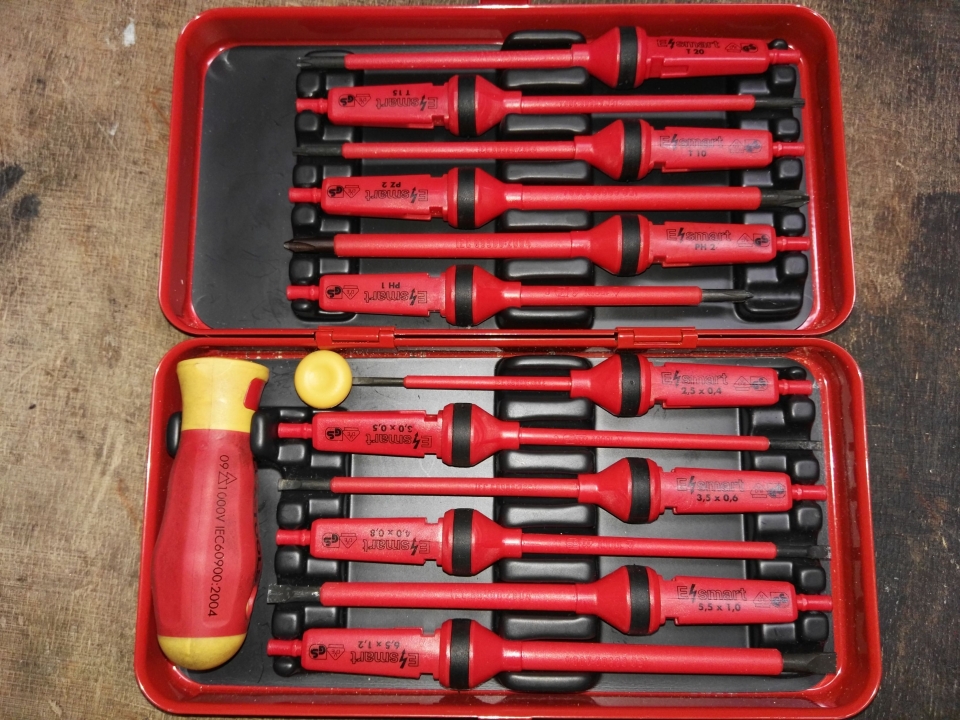

I really like my FELO insulated bit holder:
I have non-insl Klein, but mostly i use my ratcheting Snap-on with a phillips.
I also have a Felo Ergonic No.1 square for combo screws.

Bit-holders are kind of a no-no with high voltage. If a bit falls out into a panel it could vaporize it (and you). Looks comfy, though; I've been wanting to try a Felo for a while. I'm more than stocked on screwdrivers but maybe I'll pick up another just for "emergencies." :D
I, too, had this concern. I am impressed with the magnet retention. Its very strong.

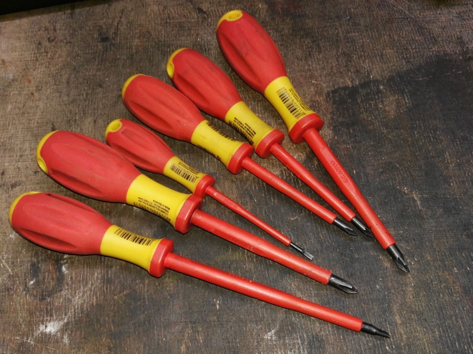

I've got the 6pc Wiha set listed above also from sears. I like them and trust Wiha to make a great product their micro stuff is top notch imho...
I just like the added level of protection should some idiot flip on a switch...
Insulated bit holders scare the **** out of me. Many times, I've removed my bit holder and seen the bit stay in the screw (this happens a lot with hex bits, but also with good fitting Philips bits).
With the bit in an insulated holder, only a short length of it is exposed, which should be shorter than the air gap required between phases. But once removed from the holder, the bit is theoretically long enough to short out things. Think about a Philips bit precariously sticking out of a screw, potentially energized, ready to fall on something below and bounce into who knows where. And you're left playing a real life game of Operation, trying to fish it out with the insulated handle.
At least with those sets with interchangeable shanks and a single handle, the insulation stays with the shank when it is removed. Snap On once made an insulated bit holder shank that would work in their ratcheting screwdrivers, but my fear above, is the reason I don't own one.

Again I come back to: don't use bit holders on electrical work.

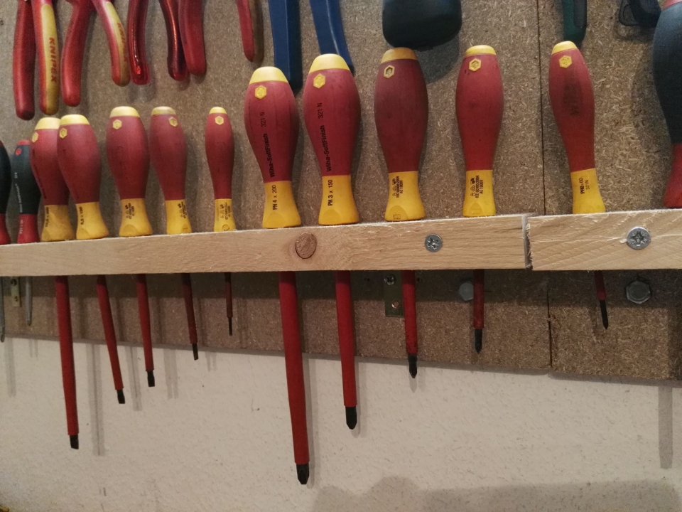

Wiha for insulated drivers. A 5 or 6 pc set from Sears or Amazon might be all you need for insulated drivers.
I also have Wiha precision drivers and love them. Got this set that comes with 7 precision drivers and a pair of nice needle-nose pliers: http://amzn.to/2bHLU4z
Drivers are made in Germany, pliers are made in Vietnam. All Wiha brand, all excellent fit and finish. And everything fits perfectly in this soft case. http://amzn.to/2bzmd2Y
You have a ligitimate concern. Especially with regards to critical components or high voltage. I totally agree common sense is needed when working hot.
However, I havent had an issue yet.
Its also interesting that there are no complaints of this on all the Amazon reviews. Oh, i might add, they are all 4/5-star. ;-)
Ultimately, to each, his own.
From Amazon:
"1/4" bits are held in place by a fairly hefty magnet. The magnet is strong enough to (very) securely hold the bit as well as hold a fastener. The magnet is so strong that smaller bits may not offer enough leverage to easily remove. I almost had to use a pair of pliers to remove a P0 bit. If my hands were greasy or otherwise dirty, it would have been a bit sticky for sure."
"This has a beefy magnet that holds the bits in well, and the whole screwdriver feels well made"
"I HAVE to take off a point for the magnet being too strong. Maybe it will get better but for now I am forced to use the extension/bit holder that came with my bit set because 1) I cannot remove most bits by hand and 2) it overly magnetizes the bits so that when you are trying to work in a tight space it will "steer" the bit against something magnetic and throw off your precision. This could be remedied by using longer bits such as the ones in impact drivers that are approximately 1 inch long."
"The magnet is almost unusually strong and very securely holds the bits in place."
"Rubber coating gives it massive grippiness, magnet is hilariously strong."
"It's a fantastic driver, the magnet is stupid strong."
"Bits fit very precisely and the magnet is strong, you won't have any bits falling out of this handle!"
"The best one I've bought. great shielding to keep from getting shocked, feels solid in your hand, and the magnet holds the bits in place. Couldn't be happier."
"Good grip and a strong magnet."
