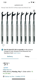

Do you think you could get in there with one of these? I used them to work on Riso machines.
I have a set of those, less useful than hoped due to the thickness of the jaws, was thinking of thinning the leading edge to a bit more of a point.
I don't think those would work. What I need are sockets as thin-walled as...
on a very small scale. Very little torque will be needed.

Doesn't look to me like clearance for anything.
What about grinding a shallow axial groove into the flats of the hex so as to be able to twist it by levering against, the bracket above?
