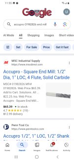

If these are nicked up like my first pics appear to indicate, do they have any value?
whateg01
Mar 13, 2006
11,887
doo dah, kansas, usa
Value? Yes. How much? Depends on the price and what it would cost to have them sharpened and how much the size difference would matter to you. Also depends on the brand. If it's a $20 EM from Amazon, they would have to be almost free, imo

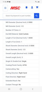

They are the Accupro part # pictured above.
badmatt
Dec 27, 2018
182
America's hat.
That’s MSC pricing.
Likely those end mills are around $30 a piece new from a machine shop supplier.
It’s whatever the market will bear at this point. The influx of cheap tooling for hobby machinists is astounding. So these may be a tough move - depending.

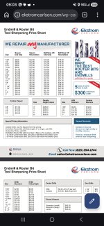

Fwiw, I don't think any have been sharpened since the coating on the bottom appears untouched. I missed that you were selling them, or had sold them. I would also return them for not being "new".
Just for fun, I pulled this sheet from the web from a sharpening service. $21 each to hit the sides and ends.

No, all 4 show signs of wear on the cutting edge of the flutes, so if you sold them as new you should refund. FWIW, I haven't used that particular model, but I have used this Accupro end mill to rough the perimeter on thousands of these aluminum parts, 2.0" axial D.O.C, .05" radial D.O.C at 130 I.P.M. To be clear, I used one end mill to cut thousands of parts and it's still going. I find them to be high quality, made in U.S.A end mills. That being said, I don't generally buy used end mills, but they are still in decent shape. They are selling new for ~$45 (sale price) on MSC which is a decent price for a quality 1/2" carbide AlTiN coated end mill, so price accordingly.

The don't appear to differ in diameter from the shank to the end, but that could just be the photos. None of the em I have had sharpened got recoated. Is that something you have to pay extra for? Or a special request?
It costs extra, so you do need to request it. Not to mention there are LOTS of different coatings, so you would need to communicate what you want when you get a re-sharp cut.
