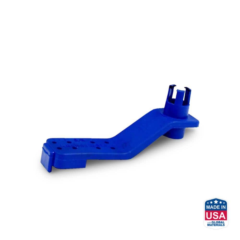

It's even easier to just put them in with positioners before the pour, then you can take all the time you want. I needed them right next to all openings and corners (for tiedown fittings) and every 30in in between because I had to build to hurricane wind code. Wet-stabbing or epoxy was going to be a pain. Positioners let me put them in the exact place I wanted--and between those and my rebar work, I impressed the inspector who gave me much less **** afterwards.

Agree with the above posts, fix position the anchors and place concrete. That's the right way to do it. Wet setting isn't allowed in some jurisdictions.
