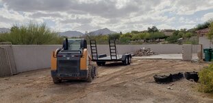

He was in the hospital for a couple of days, but his crew showed up today for demo:
Space opens right up with the wall down, bushes gone & old hot-tub pad out of the way.

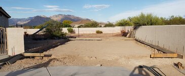

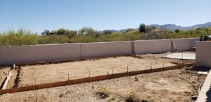

Work day #2 - trench for footer around the perimeter:20220413_01.jpg20220413_02.jpg20220413_03.jpg20220413_04.jpg
I went back after this and pulled out the couple of pieces of remaining irrigation hose. They weren't connected to anything, but just wanted to be sure that stuff was out of there.

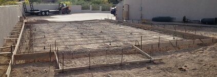

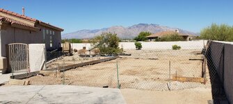

So yesterday they put a bunch of 90 degree bends in the rebar, and it looked like they drove over the pad some more. Today I was able to catch them for a minute before I went to work, and they said they're held up for the "AB" (aggregate base) / sand/gravel mix that they need to go over the pad before the steel goes in. So today they did a bunch more 90 degree bends, and they tied a bunch of pieces together to make the lengths that will become 2' x 2' grid across the slab.
My wife said they ran a ground compacting machine across the pad again. They also replaced the chain link fence at the driveway with snow fence farther back in the yard. My dogs are too smart for that, so we'll need to leash them until the fence configuration is more dog-proof. Maybe we'll get the AB tomorrow.20220418_01.jpg
Yesterday - chain-link fence at the driveway side of things.
Today - snow fence at the back, and pad compacted again.
Rebar tied to length to make the 2' x 2' grid.
More 90 degree bends, and the bending tool.

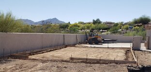

No work Wednesday, but the AB showed up today. So they got the sand/gravel in and started laying in the steel. Also braced the outer form some and added form for the man-door pad. I expect they'll be back tomorrow for more steel work, but the cement is 2 weeks out. At least we're in line for it, and they have a date.

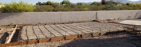

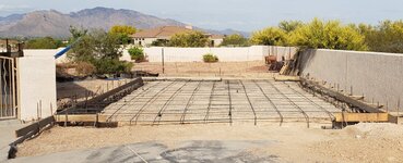

More rebar today - looks like the grid across the center is pretty much there. They also formed the apron outside the rear door, and added some fill under the man door step. Expect the rebar in the footer and inspection early next week. Due to concrete shortages and what sounds like rationing around here, pour pushed to 5/9, so other than finishing out the rebar, might not be much to show for a couple of weeks. At least I know it won't rain around here until about 4th of July.
Apron form at rear door.
Filled in under man door step form.
Start of rebar in the footer.
This (driveway) end of the footer is temporarily filled. They will dig this out and run the rebar across there. There's also some 2' x 2' footer blocks at either side of this main door.

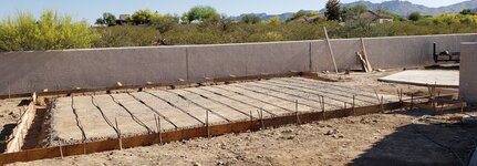

Another work day today, and then it's going to sit like this for just under 2 weeks waiting for the concrete. Dug out the footer across the front door. Set the rebar up on stands. Laid in the footer rebar, and set that up on stands. Laid in the rebar for the 2' x 2' footers on either side of the front door. Lowered the side door pad - there would have been a trapped piece of form in there the way they had it, and this puts it level with the sidewalk around the house.
Cut out for the front entrance apron.
2' x 2' footer with its own rebar at both sides of the large front door.
Lowered side door pad.

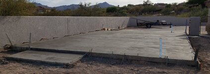

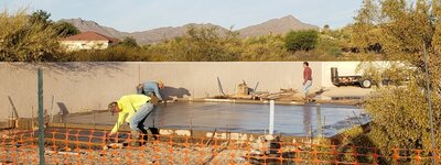

Finally, progress! Got the concrete today. They did let me know at end of last week that it would be today, but I wasn't really expecting truck to roll up at 5am. Though that makes sense, the way it heats up around here. I was able to stick around until about 7:30, and they had all 3 truckloads poured by then. The lead said it would take them until about 10am to finish. I think they did a great job with the main entry ramp and blending in with the existing driveway (which is a weird shape). Somewhere along in this wait time, they made the pad at the man door a little wider. Also get to see how the pipe for the power makes a lot more sense now.
First load - filled 3 sides of the perimeter footer, the back door pad, and a little of the back corners.
Second load - filled about 2/3 of the main floor surface.
Before the 3rd load (while the trucks were changing places) - they added this form board across the main front door for a "drip tray" style of entry. I had to go to work right after the 3rd truck unloaded, filling all of this area.
They were "broom sweep" finishing, but their lead guy thought to ask my wife, what finish? She knows my intent is epoxy, so she told them - whatever's good for epoxy. So they made it really smooth.
Here's the pipe for the electrical. This had been floating around in the form randomly, and I didn't see how it was supposed to go. But this makes sense - electrical wire will be underground outside of the building, and the pipe puts the wire up inside of the wall. You can see the old hot tub power in the very bottom right corner of this photo - run is about 6-7' across from old hot tub to the new garage.
Nice job getting a gradual slope up to the main entry door and connecting with the existing driveway. Should get going a lot faster now that it's not held up for one key sub.
