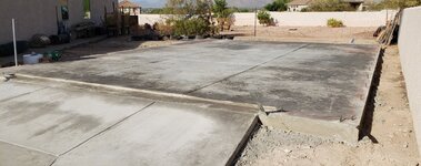

Thanks - forms off today, plus they left some material for setting the walls - foam barrier, washers, etc. Actually some clouds in the sky today and rain in the area. Usually doesn't rain here until about the July 4th holiday weekend, but there was rain to the east and west of here today (9 June). I thought this might be built up and dried in before rain, but maybe not.
I know - I see other threads here where you're fighting rain, building through rain, etc., but here, it's pretty predictable for there to be zero rain from February into July, then 2/3 of the year's rain in 6-8 weeks, then nothing again until late December.

I would keep that slab as wet as possible!! for a month if possible. Cover in plastic, keep wet underneath.
I sprayed mine with water 2x a day for a week and it was not enough even in March. Curled up on all cut joints.

Thanks. Saw this early Friday afternoon, and sprayed it down multiple times Friday, Saturday and Sunday. No issues with the joints or edges. These are the fairly large troweled style, not cut.

I hope you don't have issues. it took 6 months for them to really show.
That said all the track houses are poured and built on quick with no care for drying or what really happens to slab.

Unless they modify ordinary mixes - and they would in VERY hot climates, typical concrete mixes develop 75% of design strength in as little as 24 hours. Physical movement, i.e. "curling up" should never take place unless you're talking nearly microscopical movement.
Ordinary shrinkage cracking will take place but should be tight as hell and not become any bigger if built on soon.

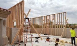

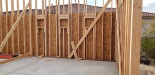

Framing started & trusses delivered. That wall is ~3 hours work with 4 guys - they did some other stuff as well - got the bottom plates laid out and cut for the other long wall, and cut the remaining studs for the designed ceiling height. Ok, it's less than efficient to pay for a certain stud length just to cut them all a little, but aside from me not knowing what I didn't know (see if a ceiling height could be set up for a stock stud length), the garage also has to comply with a requirement to be no higher than the main house, which it will make by only a couple of inches, so given another requirement that the roof style match the main house, there wasn't much choice on the wall height.
Yes, the studs are unequally spaced for a window pattern that matches what's on the main house. Not sure that anyone will ever notice, but me and the architect know that it's there. It isn't very obvious because the windows face the property line. You might be able to tell from my photos but there's nothing over the wall but the back portions of two other properties - my neighbor up the slope and another house that is actually on the next street over, so nobody will be walking around over there to see that side of the garage.
They'll let some light in, but I won't be surprised if I add blinds or something inside, as that wall is almost exactly south-facing. Also have a similar window pattern on the north wall, but it's towards the back (between the house & garage), so that's not super obvious either. But it adds some intentional design connection between the house & garage.

My wife said they felt like they were moving a little slower today. One of the guys couldn't make it, so that could be part of it. Seems like they have tomorrow planned in, and it should be reasonable to complete the sheathing of the roof tomorrow. Today completed the roof trusses, the back wall beam at the door, and sheathing most all of the walls.

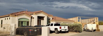

View from a ladder in my backyard. The property slopes down towards the back, so nobody (outside our yard and not on a ladder) can really see this much of the building.

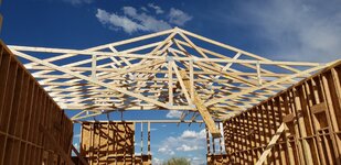

So getting the OSB on the roof looks like the lifting was done with a temporary scaffold. Got somewhat more than half of the roof sheathed today. Looks like they had to add some bracing on the shorter front/rear roof sections where the lateral (26' span) truss meets the shorter truss segments that join it to the front wall. I thought there would need to be something there, as that area didn't look like complete support for the OSB. Now that they've got that figured out for the front roof, it should go faster tomorrow to finish the rest of it. Then there's town inspection at this stage of completion.

Roof sheathing complete, and temporary bracing removed.

Framing inspection today. No pass. Not enough little clips and straps. So contractor will be back to add a little more steel, and then hopefully things can continue.

Saw some of the clips added 7/1, then I went out of town. Back on 7/5, and saw they'd installed everything, but the retro hold-down was in the wrong place. Yesterday it was pulled out from the wrong place and sitting in the right place, and the windows were in. Today, the retro hold-down is nailed to the stud, and it looks like the bolt is there, but not installed.

I like the hip roof design. That's gonna be a great space. Looks like your at the base of the Tucson Mts??
Who is your contractor using for the roof, if you know?

Scott W - they had the hold down installed in the wrong place with only the expanding bolt. I guess I'll find out in the next couple of days what will end up here.
drmarkr - for the trusses, they used MiTek USA Inc. I'm not sure how to contact them in Tucson - the contractor did that. For the truss installation / assembly and sheathing, the contractor has his own crew. For the tile, the installer will be Ruiz Affordable Roofing in Tucson.

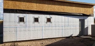

Scaffolds delivered Wednesday the 13th. They completed the top row of foam panels. No action Thursday. Nobody here yet today (Friday).
They set up the scaffold outside of the wall on a slope, and there's extension pieces that reach back over the wall, so building this distance from the wall actually works pretty well for scaffolding.

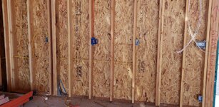

This week for electrical rough-in. First day (Tuesday), didn't look like a whole lot happened - just some of the outlet boxes on the walls. Maybe wasn't a full day. Nothing yesterday, then today, there's pretty much all the junction boxes on the walls, ceiling, for the exterior lights, and a lot of the wiring laid into place.

That about finishes the electrical rough-in. They did add the line for the AC, but no outside junction box for it yet. Not sure if they need that for inspection or not. Otherwise, I think that's pretty much it.
