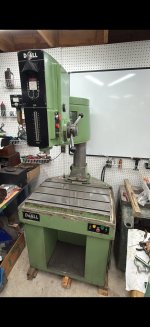

Congratulations Magic, looks like you found a nice clean machine.
I still have mine and I use it often. Everyone that sees it in operation is in awe.
PM me with your email address and I will send you a copy of the elusive manuals I have for the DTR28.
Someone on the internet tracks me down at least once a year looking for the manuals.
I also have that supplemental floor table for the DTR if you're interested. I have stored it for years because I refuse to scrap it. I will sell it to another DTR owner for a very reasonable price.
Mac I sent you a PM not sure if maybe you didn’t get it because I’m new and perhaps on messaging restriction until I’ve got more posts?
