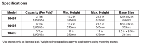

Question on the Esco stands. I read 3000#s but its was always my understanding its in a pair, so is it 3000# alone and 6000# paired or 1500# alone and 3000# paired??
Esco says 3 tons each stand on their website
https://esco.net/product/3-ton-performance-jack-stand-pair/

For anybody following this thread, I have the standard 10498 ESCO stands and I like them, but the minimum height is pretty tall. They are good for an SUV but too high for a car. The 10499 are a much better option for most cars!

I have 2 sets. Gray set (6600lbs) from many years ago.
Red set (6,000lbs, with cross braces) set from about 5 years ago. Both sets clearly labeled.
That’s each stand.

The problem is- is that per stand or per pair? The new ones are also clearly labeled at 3-ton, but nobody, including Esco, seems to know if it's per stand or pair. My understanding of the ratings standards is that they are rated per pair. But...
Since you don’t need to buy a pair, my ASSumption is each as they are individually labeled.
That said, I don’t have a definitive answer.
My ASSumption likewise is that the manual that has all the legalese and warnings from the lawyers in it is correct and the website put together by whomever is wrong. I also noticed looking at the heavier duty 5-ton model on the website, it is stated per pair. Would be great if Esco would chime in!

I posted another thread two days ago about single vs. pair ratings. Glad I did. I got an excellent reply from someone (whose name I forgot, but always has good info) that a 2015 ASME standard now requires jack stand capacity to be listed per pair.

If you watch the Project Farm destruction tests, a single Esco fails at >25,000 lbs; as does most anything but the most ghetto stand.
