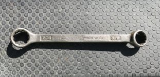

I use the stuff a lot for rescuing old tools. Usually an overnight soak. I have a variety of different size and shape plastic bins stacked up in the garage to choose from. You can get by with less Evaporust by putting a solid object or two into the bin. I often use a can of paint to displace volume and raise the level of Evaporust in the container.
As 4xdog said earlier, be careful about dunking half of an object at a time. The surface of the Evaporust will leave a line which won’t disappear after you turn it over and dunk the other half the next session. If you’re painting, no problem but if you want bare steel, that line will show as a discoloration.
Your object will come out black with carbon as a result of the chemical reaction. In my experience, that is easily removed with gentle wire brushing under running water. Of course, make sure to dry the object right away with compressed air, a heat gun, a quick shot with a propane torch, whatever works for you. And then either primer paint, boiled linseed oil, fluid film or anything else to prevent flash rusting.
Here are before and after shots of something I rescued last night. Somebody lost this pair of loppers. They laid around partially buried in the dirt under a tree or something like that for at least a year.
I soaked this tool for about 6 hours leaning against a wall upside down in a 2 quart plastic freezer container. Evaporust gets to the rust in between moving parts so complete disassembly is unnecessary. These loppers now work like new. (I sharpened, adjusted and lubed of course) With more time and effort, these would LOOK better but these guys are going back to work.
(BTW, Evaporust won’t work below about 55 degrees...warm it up a bit and it speeds the reaction)
