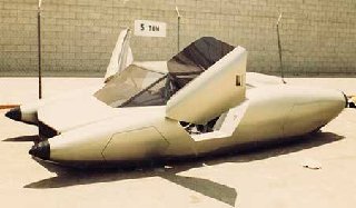

I know a fair bit about 'glass myself..30 yrs worth., so wth I'll post some pics of the mantis molds, material layup tools etc..also applies to boats altho I dont use epoxy on props. One thing about fiberglass and you'll find out right away once you grind it ..if your impervious to it or not..ie if it makes you ITCH like hell or doesnt bother you. And grinding 'glass you need rough discs..ie 16-24 grit, 36 is so so but will wear down fast. Wear face mask, dust masks or respirators etc etc
