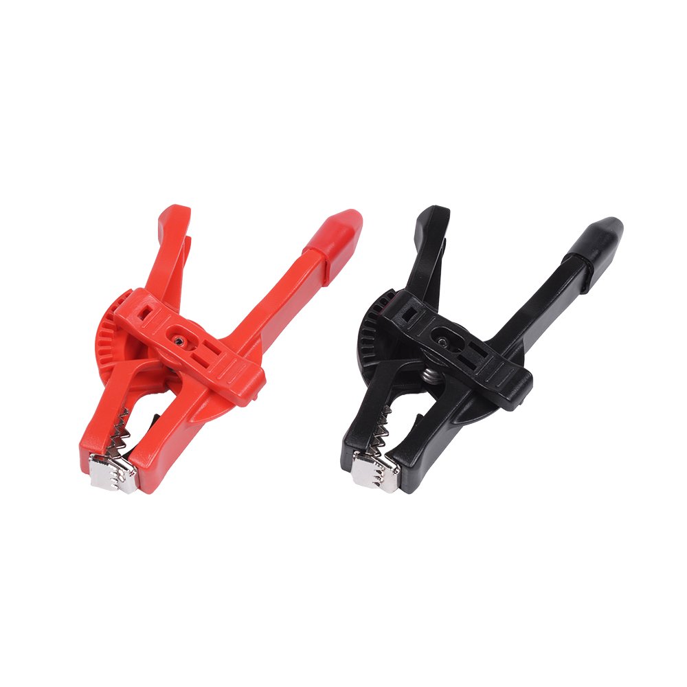

For memory backup, if you were using the regular clamps on the cables, it is possible for it to slip off or you accidentally knock it out while lifting out the old battery.
I found this clamp recently. It has a plastic catch that you push in, to lock the jaws. I have not tried it, but it seems to have potential.
https://www.amazon.co.jp/gp/product/B07F9SZNXS/
