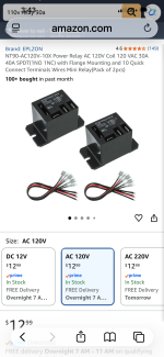

I ordered a couple of these for a project today. Maybe they would work for you?IMG_0226.png
