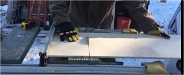

Is this an aftermarket fence/router table system ? If so, who make it.

I think it's part of the Ryobi BT3000 or BT3100 table saw. I believe it has been discontinued.

Wow, those pictures look like a pre accident photo shoot.
Yup, Ryobi. Those BT’s have a following.
The operator is a well qualified, experienced carpenter working outside in the snow, so I do not question any of safety gear.
I looked up some images of those Ryobi saws. The look similar but do not have the yellow plastic end caps.
Lol, whenever I see someone wearing gloves while operating rotating machinery my sphincter puckers up....:beer:
That and the board doesnt look flat against the table, just waiting to bind.
Never saw the need for a contractor saw like these, if I can't cut it close enough with the skillsaw then it's probably a finished piece and every portable table saw I have used can't make a finished cut worth a damn anyway.
