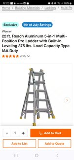

I have a Werner 22' ladder that folds pretty small and you can run it in an A frame configuration up to about 11 feet I suppose or open it all the way up and it will go to 22. It's not a light ladder by any stretch but probably lighter than a true extension of same size. It's pretty wide at bottom (and top if opened up and fully extended) and narrow in center. It's very stable. Believe it's rated 375#. I realize you said weight is issue. You can remove the outer pieces on both sides if you don't need full extension. It's a pretty versatile ladder and fits in back of my pickup.
ETA like this but mine is older and doesn't have leveling feet. It's 47# though. On sale for $199 which is killer deal believe I paid close to $400 when it first came out.
Way too heavy and a bit tall for my intended use.
Perhaps I need to look at single leaf ladders. It seems that a 12 ft single is almost as tall maximum height of a 16 ft two leaf extension ladder.
I have the shorter version of that type ladder. It is versatile, but it's too damn heavy for most of the time I need it. I leave that one out in my (detached) shop and have a 6 ft fiberglass one I keep in (attached) garage. The fiberglass one is soooo much easier to manipulate, but granted isn't as tall or versatile.
BTW I hate the labeling of ladders as "22 ft *reach". It's misleading at best.
cgrutt
Mar 4, 2016
8,400
Yeah it's heavy but good for what I use it for. What I like most about it is the fact that it fits in back of my truck. Not sure what you mean by misleading I believe the ladder itself measures 22' when fully extended. I was just using it this past weekend to install cameras on 2nd story soffits and had no issues at all with it.
