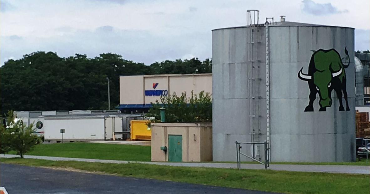

Here is something else that popped up that might indicate an association:
