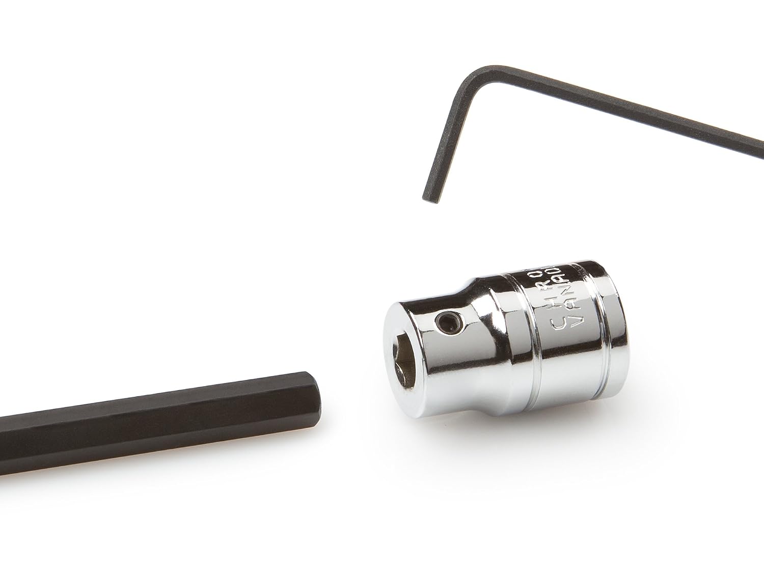

What do you like?
Tekton for $24
Neiko for $18
Is there any advantage of this design by Tekton?
mark.dziamski
Aug 27, 2015
74
Central California
All I can think of is hard to reach places. I have extra long Allen socket with the ball end for taking the pneumatic actuators off commercial valve bodies

That design is good because you can cut the head of an Allen style and use it if you damage a bit
Jacobson,
The problems I see with the Tekton set are that you can possibly lose the set screw upon removal and the quality of the steel for the low price.
You might want to consider the Bondhus Prohold bit socket line. Bondhus has a great reputation on GJ for durability of their hex keys products. Bondhus Prohold does away with set screws. There are two buttons made from a proprietary material at the end of the socket to allow easy insertion and removal of the bit. Here is an Amazon link to a Bondhus Prohold Torx bit socket set: LINK.

I have a Gearwrench set I bought at Advance Auto . It was like 30 bucks. No issues. Only used them a few times but they seem nice for the price.

I have the tekton set . the shaft holds up well to daily use with a m18 impact but the set screws like to back off occasionally so put a little bit of blue locktight on them and your good to go im an industrial mechanic by trade and i likem alot
