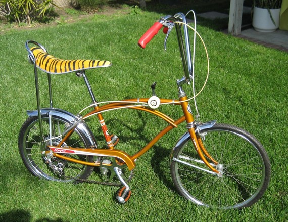

I once used 1/2" conduit to extend the forks on my Spider Bicycle....a lot of us in the late 60's did that!
I had one like this...
I use 1/2" 10 footers in the basement laundry area to hang clothes on clothes hangers to dry.
I have made curtain rods out of them,
Balusters for the deck....
....canopy frame and a bike rack.
