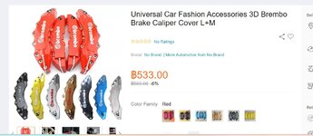

The calipers need to be protected as well. The peace of mind these provide is well worth the $15 investment.brembo .jpg
