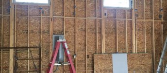

Regarding outlets - I went a little crazy. I believe the total # was 66 on the first and second floors. I put blue tape where I wanted each outlet and the electrician wired them up for me. You can see in this picture the blue tape on the walls and the adjacent outlets.
They ended up wiring all the way around even where the furnace ended up. Once the unplanned placement of the furnace became reality he had to cut those off and bypass them.
The upper outlets were wired every 3 feet or so all the way around the garage except for over the overhead doors. This would be for neon/sign/etc lighting. I've seen a million pics of garages with long cords strung across the wall to the signs and did not like the look. These outlets are switched and are split into left and right sections with two separate switches.
Everything was great until I got his bill once he was done with the rough - holy ****! I ended up finish wiring nearly all the outlets and saved a couple grand. He was cool and let me do it myself.
