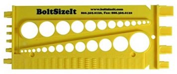

I have this one. Was ordering something online and needed something for a couple dollars to get free shipping. Sometimes hard to tell which threads but it has come in surprisingly useful. Most of the time I use it to see which tap or die to use.

Will the BoltSizeIt and similar work for sheet metal and wood screws too? I sorting my collection too and and finding slight variations.

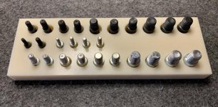

I took a small piece of 2X4, drilled the appropriate size holes in it. Then I grabbed a nut and bolt of every size I had or would need, verified the sizes with thread pitch gauge, screwed the nut on to the bolt, and stuck it into a marked hole. Takes a few seconds if I need to check a screw, as I have to unthread the test nut. If checking a nut, just pull it out of the 2X4 and check - the matching nut is already up on the screw far enough that it's out of the way. Cheap, I'm not, frugal I am. :dunno::tard:

If I was just sorting boxes, I’d use the yellow thing that big head posted, and worry about pitch later. But honestly, when I do it, I size one screw of each size, then just compare to what’s in the box.
No; the ones you'll typically see are for machine thread.

Hardware store ( tractor supply if you have one, buy by the pound), buy a nut and a bolt in every size you are interested in..... screw the nut on the bolt, drill holes in a block of wood and label with the sizes. Not as handy as the thread checker set, but cheap and serviceable.
