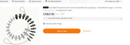

Funny my old thread got resurrected, I never wouldn't up buying one and started thinking about it again this week.
I didn't buy any because most of the options shown are big and take up a lot of space. Not if I had a house with a garage, but in a studio apartment where most of my tools are in offsite storage, then a 10" x 10" board with different bolts takes up more space than I want to dedicate to checking thread pitches once or twice a year.
I think this was suggested and idk what I was thinking at the time, but it's really small and seems like a good fit for me. Unfortunately I've started an informal Starrett embargo since I dont know which of their tools are being made in China at the moment. I guess I can buy online from a retailer with good free returns (prepaid shipping label) and give it a shot.
Another idea I like, I dont know how good of an idea it is, but I really want to buy a tap and die set, and also a thread cleaner/repair set. I think I can use those as a thread gauge. Use the taps as a gauge for nuts, and use the dies as a gauge for bolts.
It might not be as efficient or pretty as other means, but I literally only find myself needing to do this once or twice per year and I do want both a tap/die and a thread repair set anyway for emergency purposes.

I wanted one of those thread checking boards that you see in hardware stores. But there were/are times when I can't bring whatever I need to identify to the board hanging on the wall or whatever. So instead I bought the cable type.
Just an FYI if you do get this style. Not sure who makes the original, mine says the original Thread Checker on it but I'm not so sure of that, doesn't matter to me anyway. But the one I first purchased (& returned) had labels for the thread sizes, I think it was named Thread Detective. The labels were thick & seemed heavy duty but I didn't trust them to stay on forever. Get the ones with the thread sizes engraved.
It does come in handy from time to time but I still usually do it this way.
on the cable type, buy a second one and remove all of the threaded checkers. Thread those removed ones into the back of the first set that is still on their cable. Now you have a set of thread checkers that can also be easily removed to check a thread down in an engine bay or something without having the whole snake of thread checkers in there.
