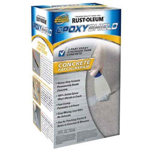

http://www.homedepot.com/p/Rust-Ole...oncrete-Patch-and-Repair-Kit-215173/202097324
I used this last fall to fill in 3 control joints of about 16' each before I put down Rust Bullet. So far so good. I can't even find where the control joints used to be.

^^^How many coats of RB did you put down? Did you have to sand the concrete patch & repair kit at all (I read it was incredibly hard to do so).

DC73
Dec 27, 2014
1,627
Lubbock TX
I put a diamond grinding wheel on my angle grinder to get the epoxy flush with the concrete. It made quick work of it but you have to be careful not to put gouges in the concrete.
For the Rust Bullet, I did 2 coats of gray, flakes on the 2nd coat, 3 coats of clear with anti-skid. Didn't necessarily need the 3rd coat of clear but I had enough left to do it and figured I might as well use it up.
