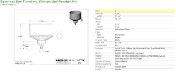

Trying to source a funnel that can hold 3-4 quarts and has a decent screen... maybe 100 mesh or so.
Needs to be able to flow oil, like gear oil, hydraulic, etc.
I've found small ones and used paint filters. They only hold a cup or two.
The oil I have to "filter" is in gallon jugs so would be way less tedious to be able to dump the whole thing, or at least most of it.

Try searching on "FloTool Red Giant QuickFill Funnel"
This is what we use at work..
I don't know where you can get it in quantities of just one.

...I don't know where you can get it in quantities of just one.
I have one of those too. Picked it up at a car parts store 20+ years ago. The brass screen was cast into the plastic, but it flowed so slow for me (with gasoline), that I punched it out.
