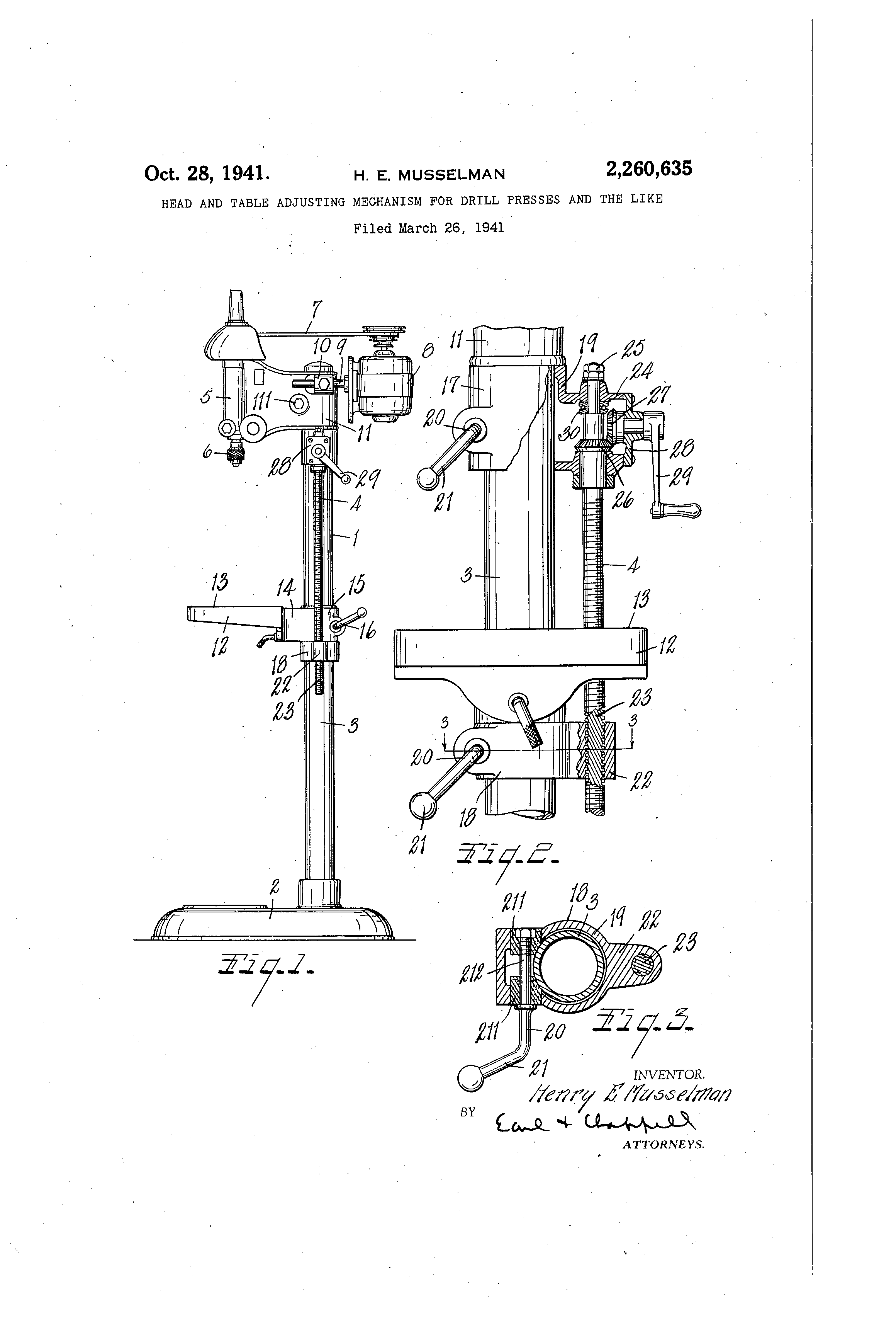

I also have come across this craftsman model 103.23141, and had it given to me by an old friend that shut the doors on his fab business. Does anyone know where I could get replacement parts for it, to fully restore it? So far, I have not had any luck, except for a replacement belt.
The parts that are missing are parts no.18118(Head lock sleeve), 18626(Head lock screw), 18110(Lock handle and screw). It does not appear to have the vari-slow option, or the table lift.
