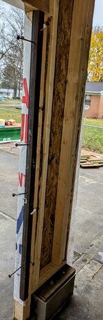

I was adding reinforced steel into the wall for the deadbolt during construction. I want to keep my tools and vehicles safe from any smash & grab burglary attempt. Very important to have an accurate measurement when adding 1/4 steel into the studs before the walls are closed up and doors added!
I asked how many horizontal reinforcement struts are included with each garage door I was ordering? Another default printed page and blank stare, I ended up ordering 4 additional 16ft struts, the 9x7 door only came with 1 horizontal reinforcement strut. But when I opened the 16x8 door that kit included 4 (it has 5 panels), and I had to returned the rest, and made another comment asking when the General Manager works? The door kits included plastic Rollers, I asked for heavy duty metal rollers, another blank stare and they showed me the garage door parts isle and I ordered them separately (which I didn't have to apparently).
All this gave me the impression this was all they were capable of, so I ordered my High Lift Kit parts from a quality garage door website and made the changes myself. Preferred Doors in Texas has a full catalog of garage door parts on their website and a helpful customer service. But nobody will give Torsion Spring recommendations on the phone or email because of the liability. When I returned to Menards asking for larger springs is when the 2 older guys were belittling me for ordering the wrong doors/kit/parts. I showed them pictures of my door progress after that surreal moment calming down. They agreed I had the correct Brackets, Cables, Drums, Bumpers, etc. That's when those 2 employees informed me I could have gotten all the correct: Horizontal Supports, Drums, Cables, Spring(s), Brackets, Rollers, Track Bumpers, etc included in my door kits, and not had to wait additional months for these extra orders and spend $700 on parts I already had (the standard incorrect versions of). They also have told the General Manager I'll be looking for him one day.🤬

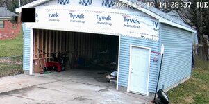

Yesterday was a good weather day, almost 50°F, I finished the siding on the front of the garage, but after sunset.👍 Knowing I'd wake up to a cold heavy rain all day. But I can rest knowing the front siding is completed, here is a rain soaked morning progress picture.
(Center blocks are for the kids basketball hoop, left block is for the fire alarm Red Bell & Strobe, while the right block is just an unnecessary basic air vet for a symmetrical look. Symmetry is hard to obtain with the doors, but I can always remove that vent and splice in new siding if it's a bad aesthetic)🤔🤷🏻‍♂️
Next a couple days of clean up, as I didn't care where cut pieces of siding fell after 4pm as the Sun was about to set. Might start setting up interior cabinets along the wall. Still waiting for garage door tension springs before I install the 16x8 front door and it's stuck down without the ability to go up. Once they come in that should go faster than the rear 9x7 door I was piecing together the High Lift Kit. Now I have all those part and know where everything bolts together.

I was able to finally finish all the siding to the gable peak last month with my Father-in-Law, that task is completed and closer to a building inspection and PASS!
Unfortunately when I was knocked down, the top panel landed on my left ankle and I was pined to the floor. I skipped the unlock and scroll my contacts for help, I just pushed the Emergency button on my phone and my Emergency contacts were notified I was in trouble. (selfie I was able to take)
My Sister responded to the SOS with GPS pin, got my Dad rushed over to lift the 378lb door off my foot and back up in position, I quickly drove some Spax PowerLags to hold it until I recovered (foot, head, back & pride); the next day I spent 18 hours in bed, felt like a door landed on me.🤕 I took out all that "Safe Consumer Friendly" EZ-SET equipment to return (with many additional complaints). I ordered standard 0.273x2''x45'' Garage Door Torsion Springs and bearing anchor plates online. I'm done giving the local store any more money for door parts, Preferred Doors in Texas has been great to me and never given me bad advise or customer service!(y)
Last thought; not sure if I could have fixed the door problem (without it falling over) if I rolled my scaffolding next ot the door and locked all 4 casters?🤔🤷‍♂️

Glad your ankle wasn’t snapped in all that, the angle it caught you looked very bad. Hard to say what the scaffolding would have done, I think after examining the tilted door and twisted tracks I wouldn’t have trusted the tracks to hang on to the door tight. But I do see why you were hoping just leveling it out would free it up. I think the best approach would have been to disassemble/unstack the door panels from the top, tear out the bent rails, and start over with the better hardware, which it sounds like you are doing now anyway. Hope your panels didn’t get all bent up in the collapse. Good luck!

crikey, lucky you weren't seriously injured
The door falling? Yeah, that's why I'm saving the security camera footage until everything is resolved with the doors. I'm not seeking a lawsuit, but I don't want to be left with $750 in parts I never should have been sold! They should have never sold me that EZ-SET winder system with the door I was asking for, despite it was supposed to be safer than traditional torsion springs. The EZ-SET system is NOT rated for heavier doors like mine or any door with a High Lift Kit that rolls up to the ceiling; that mistake could have been deadly. I gladly purchased the correct bearing plates & torsion springs, and installed them without issue.👍
Fortunately after 25 years as a Firefighter Paramedic; I've done confined space training, dam water rescue training, vehicle extrication, ice fall-in rescue, etc. I have experience with structural failures, and learned how to move(fall) without trying to fight the physics of an object the human body cannot stop, while protecting my head and sensitive areas from injury. These type of structural failures do not care about our meat bag of bones bodies, do NOT get between forces that will take off a limb or kill you. Too many people die trying to grab or push; a heavy piece of equipment or something sharp; and it just takes them. Similar to an exposed PTO shaft, getting to close to a lathe, hydraulic presses, setting a chainsaw on leg before it stops, unclogging a snowblower auger, jack failures when under a vehicle, trying to push a falling tree, etc ⚠️☠️
Honestly I should have never been next to that door, those "EZ-SET" springs and winders were past their limit, I feel dumb.🤦🏻‍♂️

You going to armor those door jambs as well? I put longer screws in my hinges and latch, but it was kind of pointless since they could just break out my glass and reach inside to gain entry. If nothing else I figure it will slow them down a bit, or force a would-be intruder to make lots of noise.
Yes I have steel armor reinforced door jams with 3½in hardened screws into the King & Jack studs. I don't have any windows in or near my doors. While every window is 1/4 tempered glass outside pane and 1/4 laminated security glass inside pane. No cheap 1/8 annealed glass in my house.😎
I had to pre-drill the holes in the 1/4in Angle Iron. I replaced all of the door screws with these structural Grade-5 screws.👍
