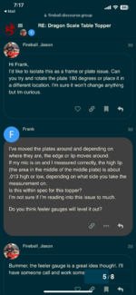

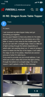

I ended up ordering the Fireball table topper for about $1100 shipped.
Even though they claim the aluminum frame is machined, the plates are not level. they are about .018 to low. A square sliding over the plates catches the edge of the opposite plate.
Sent fireball an email. They told me they are willing to sell me some shims and give me a 10% discount off the purchase of the shims.
I responded back asking for clarification if it was 10% off the shims or 10% off of my order and it was confirmed it was 10% off of the shims. I responded that I’m a little confused after spending this much money that I would have to spend more money to fix your quality control issues.
I also stated that the table in question is advertised on their website as being 3/4 of an inch thick. The table is actually .69 inches thick. If they want to drill precision holes 2 inches on center at 5/8 of an inch in diameter then you would think the plate would actually be 3/4 of an inch thick and not .69.
I’m waiting on their response.. But yea, I’m not happy one bit.
Below is a YouTube video that I sent to them showing the issue with the plates not being level.
Am I asking too much here or over reacting?

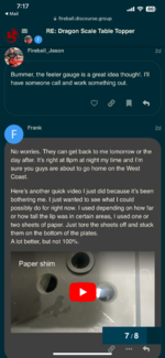

So customer service never got back to me. Last communication with Jason was 4 days ago when he said someone will call me and work something out.
Never got any phone calls, just the emails from CS saying they want to sell me shims for 10% off.
But according to Jason from 4 days ago, they don’t offer shims!
For some half way good news to me.
After about 3 hours of taking the plates off and reinstalling them, without exaggerating it was probably 30-40 times for each plate, I was finally able to level the plates out with feeler gauges that I had cut into small 1” pieces.
Everywhere there was a bolt, had a feeler gauge next to it.
Sizes ranged from .002 to .020
Flatness across the table was good according to my bubble level that has a machined side to it, but who knows how accurate that is.
I was happy with the results…….
Today I was welding together some horse shoes that the kid wanted me to build some projects for. After adjusting the work piece a few times with a rubber mallet, low and behold one of the plates rose up some and gave me an edge like it did the other day.
I took the one plate off that was taller and didn’t see anything out of the ordinary. Looking at the threads of the bolts that hold the plates to the aluminum frame, you can see where there are aluminum thread shavings coming out of the bolt holes. The frame the plates are mounted to are Aluminum. Maybe they should have used steel?
There is no doubt that the rubber mallet used to adjust the pieces allowed the bolt or bolts to release a c*nt hair and which then allowed the plate to rise again. I can only imagine what the bolt holes would look like overtime if this table was used on a regular basis.
So yea, this setup is going back. I’ll email CS tonight and request a prepaid label so I can ship it back to them.
