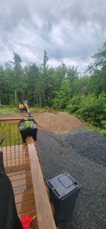

Got the land cleared this week. Was a real treat solo in 30 degrees.
All in took down a little over a dozen trees small to medium large, and hauled out over a dozen truckload of brush.
Got the first 4 loads of pit run dropped today. Hopefully concrete goes in next week!20260612_144640.jpg20260610_132701.jpg20260610_132736.jpg
