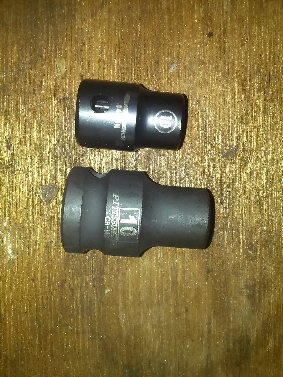

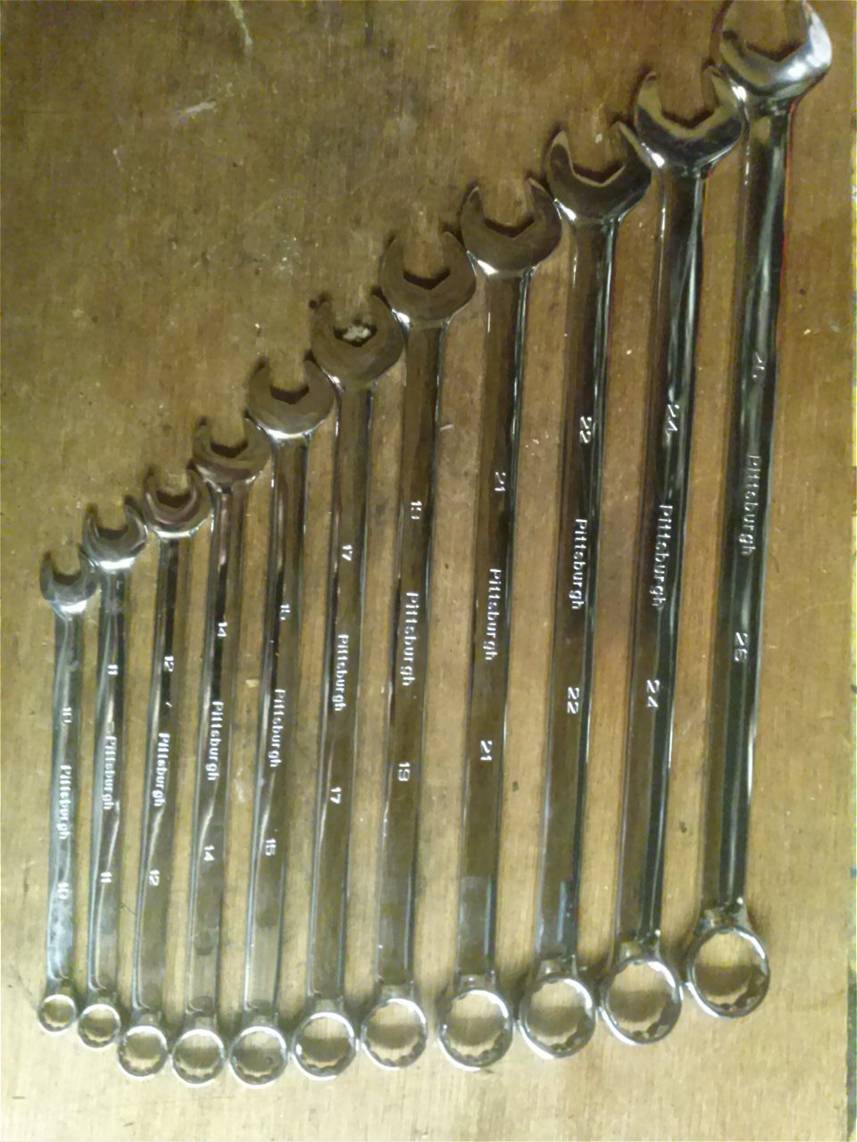

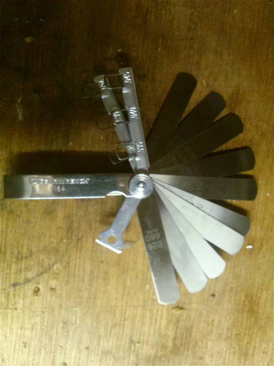

Here are the latest additions:
Gearwrench feeler gauges, $7 at Ace:

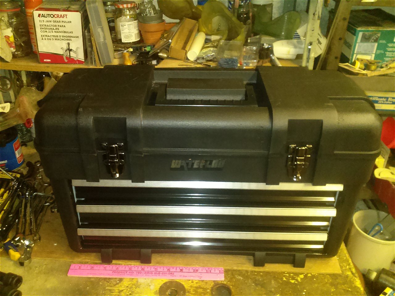

As nice as those long handle wrenches are, I don't want to haul them around all the time:

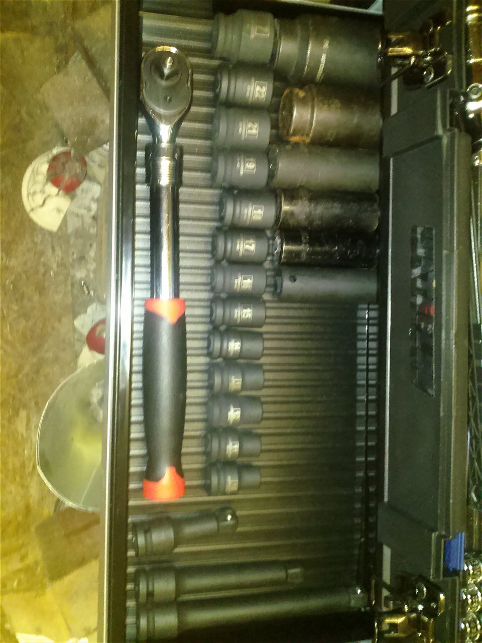

The 1/2" drawer is about as complete as it needs to be; I'm just going to fill out the SAE and deeps with singles as I need them, leaving me one empty drawer for a 1/4" set:

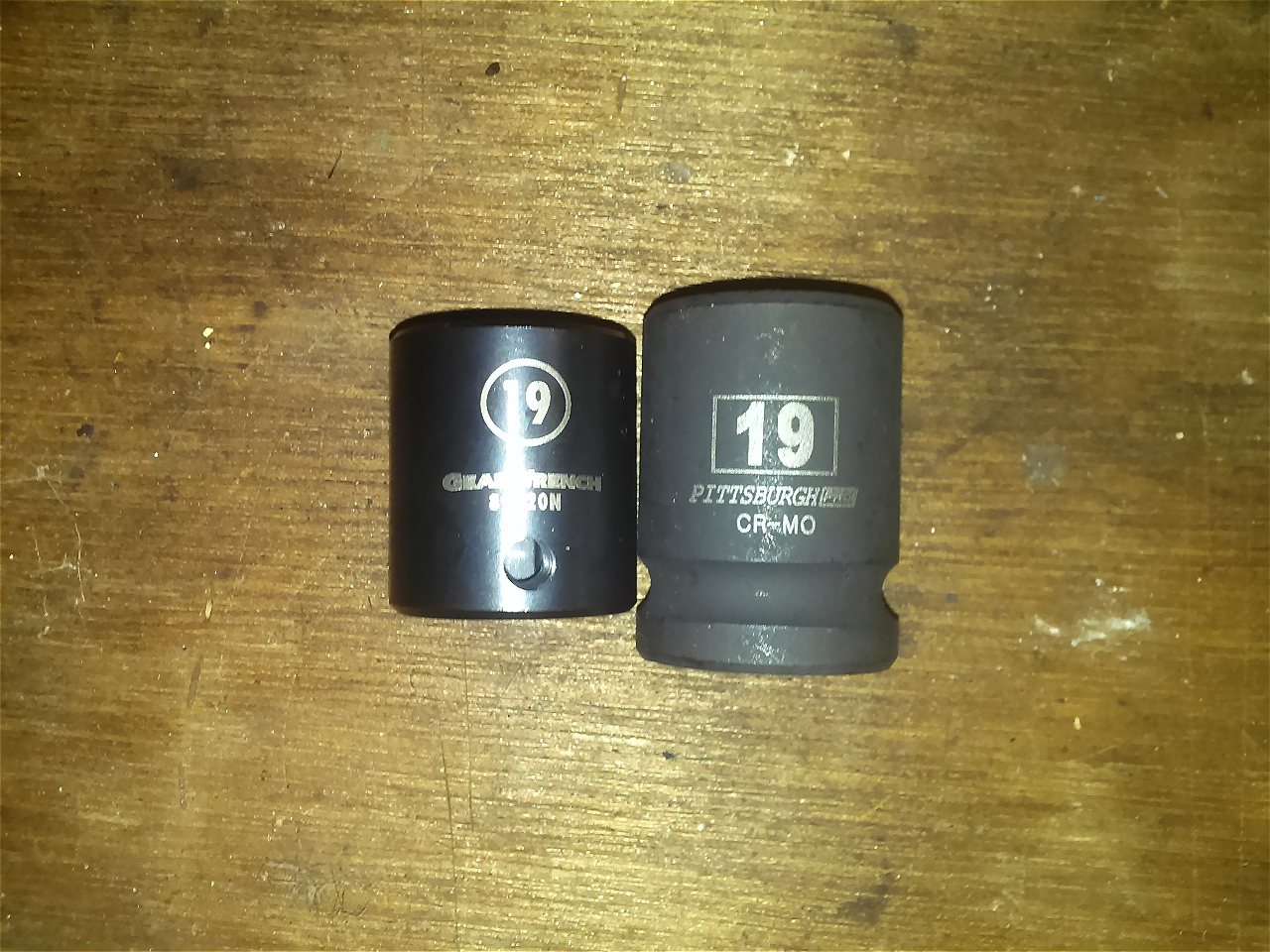

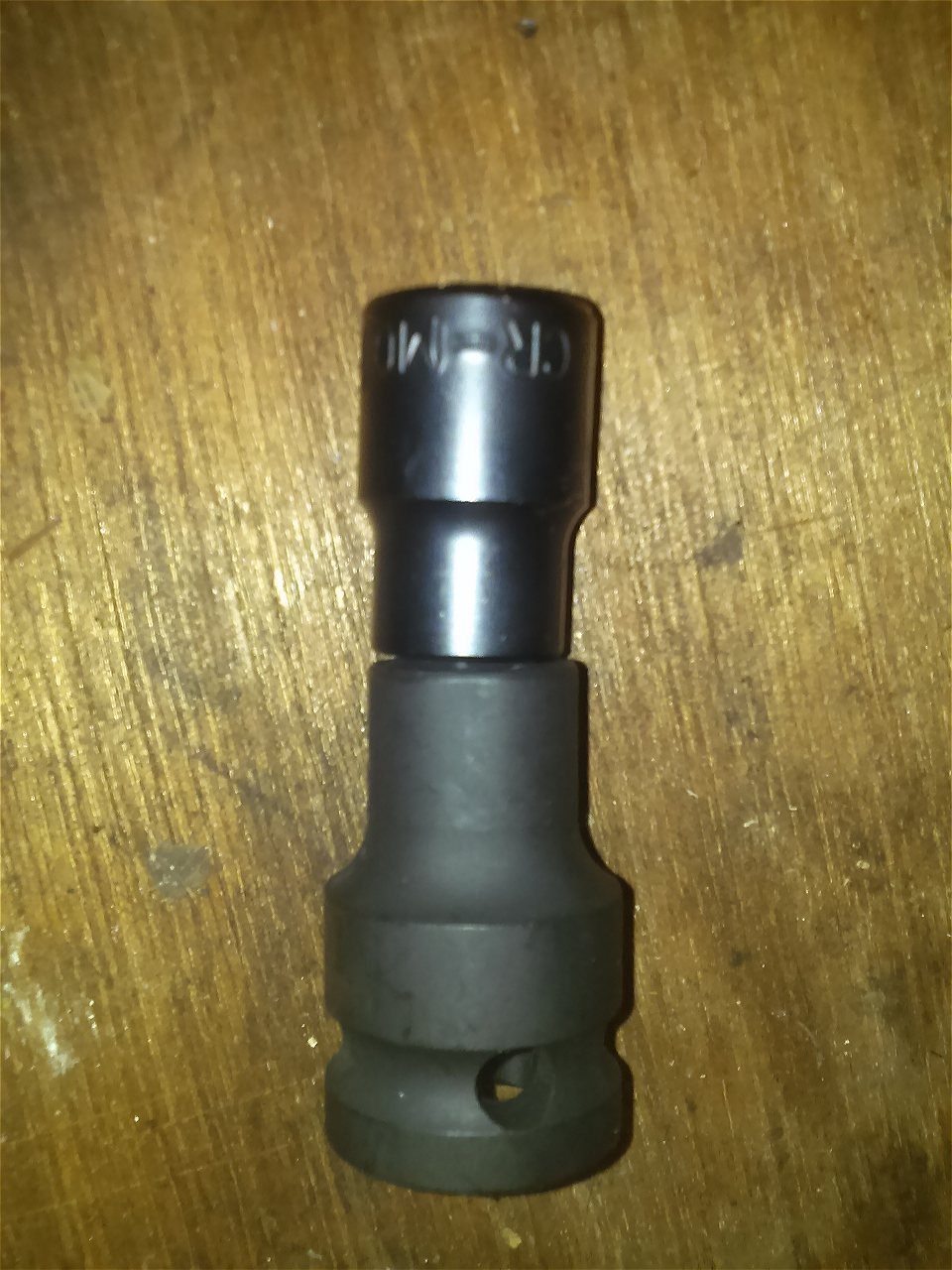

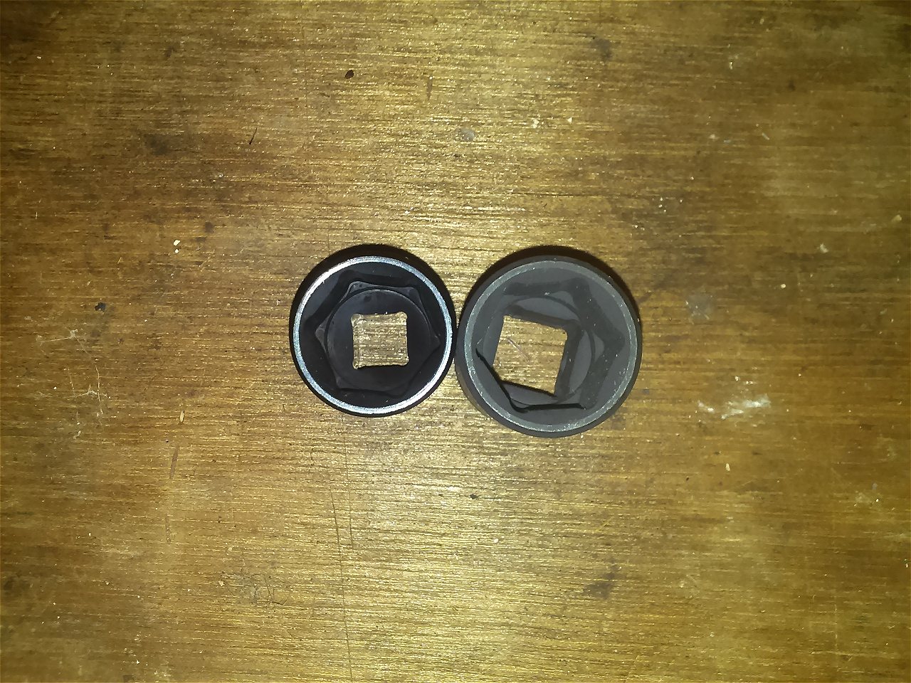

Here are a couple of 1/2" Pittsburgh Pro impact sockets next to my 3/8" Gearwrench impacts:
Not too shabby; the 10mm is a little thicker, but the 19mm is almost exactly the same.

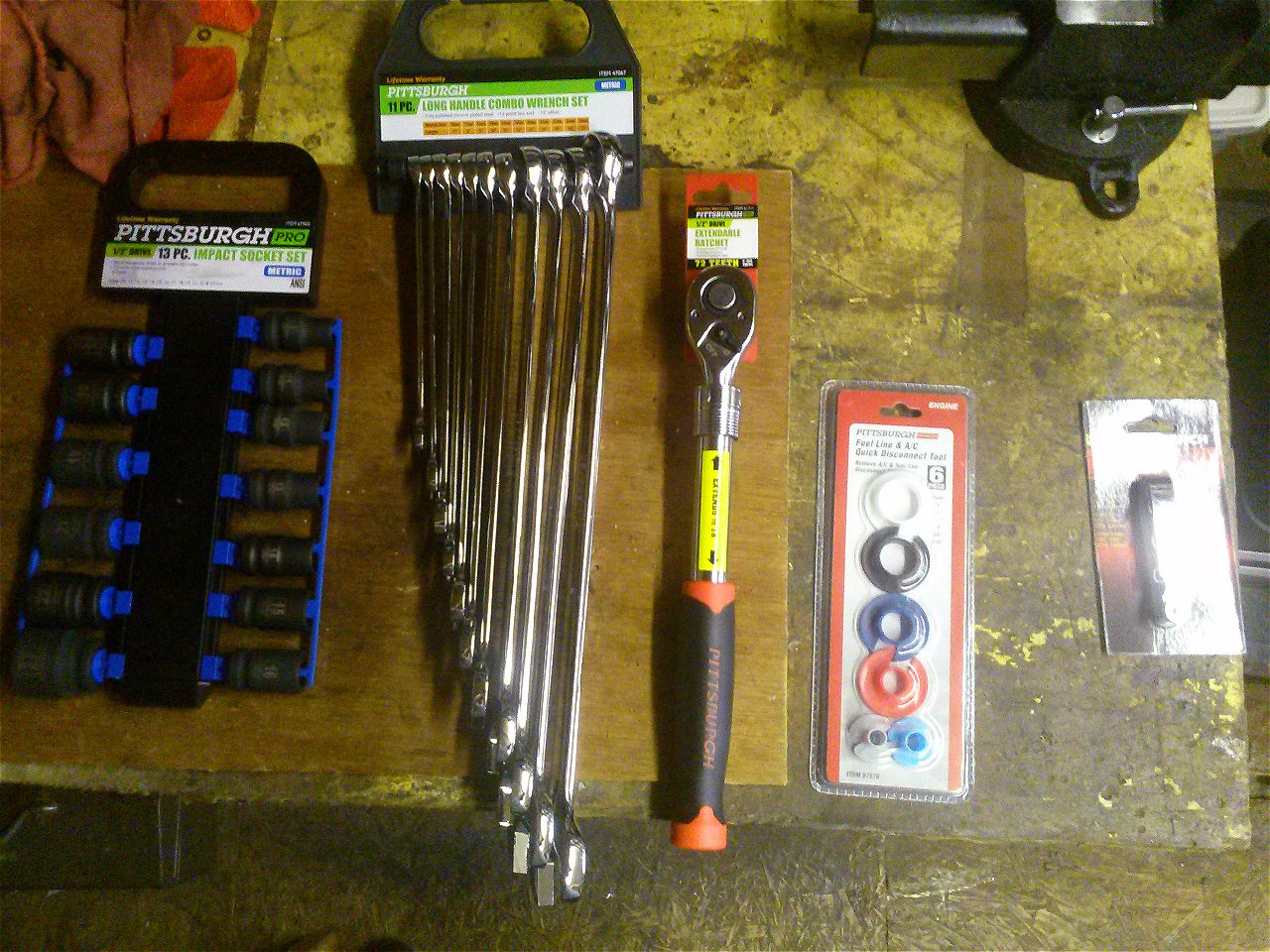

Next on the list:

The long wrenches look nice. Let us know how they work out. You should post some pics of the jobs you're doing with these tools.
