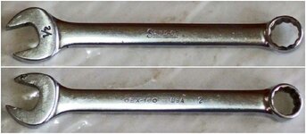

Last week, I got 1942’s Snap-on combination wrench with Snap-on logo by US ebay.
Let me know which year’s one was first Snap-on with Snap-on logo.
I know Snap-on combination wrench was launched 1934 with Blue Point logo, next year of PLOMB one.
I would like to know the first one with Snap-on logo.

I got this at the same time by ebay.
I believe this is 1948 which is the first Snap-on with Snap-on logo.
