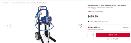

You can do some things to make it go better, but cheap paint guns and old paint don't mix well. Some things to do: mix the paint thoroughly and thin to proper viscosity as described above. Then, strain all the paint. Practice a bit, won't need much. From what you describe, you're probably painting outside house or fence or similar? In that case, prep is important. Clean well. If you pressure wash, wait a week or more in dry weather to make sure you get all moisture out of cracks, overlaps, gaps, etc before you paint. Make long horizontal runs, keeping the gun absolutely 90 degrees to surface, don't flex your wrist to move the pattern horizontally, as it will also change application rate as the angle changes.
For exterior painting, an HVLP type gun works, but is slow. I sometimes use my turbine HVLP outside with water base, but much prefer to use an airless. But, $500 or so is minimum entry level for that. Well worth it, in my opinion. Works better and easier, and 10 times faster. If you're just painting your house, buy one, run it for the job, and resell to someone else for 80% of what you paid. Cheaper than renting, and you don't get some dog of a rental tool. I generally reserve my HVLP for applying varnishes and stains, and for oil based paints. It's way too slow for latex paints, compared to the airless.
Great advice! Thanks!
I'm repainting a flower pot I made for my grandmother. (Really a cover for pots, so she can save $50 a pop and use the basic black ones LOL).
If I filter it and thin it right, what would go wrong? Will it not dry right?
As for the airless, is that $500 unit really good or is that going to give similar results to the $77 help one I have? Would getting a used unit make sense (I want one for house painting at some point, but don't really paint or even finish things much at the moment). Also, would a pneumatic gun be ok, or is that just as bad as the other help guns?
Boogerman
Jan 28, 2021
837
aspen cove hill
This is a decent paint machine for $500; used can be troublesome, I like to use a few times, then sell for $350 to someone else and buy another $500 one next time. Cost per use comes out cheap, and don't have problems.
