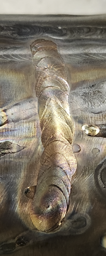

First timer - TIG welds are gray - tried everything :(

I put amps to 50+ and here is the result,
I just dont understand, why at the start i am getting gray like 90% of the time, but in the middle it looks good, also when I finish it looks good,
at the start I tried staying more or staying less but didnt help, not sure whats going on, but at the same time, if I do not use filler rod, the start area does not look gray, this is not making sense to me :( , why at the start with filler rod i am getting but not all the way
45 second video of the 2.5inch tube i practiced today at 50A and 30cfh

Lookin good my friend.
I believe I had mentioned it about pre-flow and bumping your trigger to get the gas flowing before you start. This will help greatly but you have to remember to do it haha. It will basically get your post flow started so your lines are full, then you can start to weld. If that makes sense.
I think you are definitely improving and moving in the right direction. If you have enough tubing, try cutting it and tacking at 4 equal points and fusing (autogenous) each joint.

i cant find any foot pedal for this specific model/welding machine, I will start gas before welding this time. yes, i will cut the tube and practice again.

hi,
I am practicing TIG welds for first time so i can do welding on my custom headers, welder is running at 120V
The settings I used are with 100% argon
tried DC TIG + 4T + NO PULSE + 0.3seconds pre flow + 3 to 4 seconds post flow + cup 5 pink + 1.6mm red Tungsten Electrode Red - 2% Thoriated
tried DC TIG + 4T + PULSE + 0.3seconds pre flow + 3 to 4 seconds post flow + cup 5 pink + 1.6mm Tungsten Electrode Red - 2% Thoriated
tried DC TIG + 2T + PULSE + 0.3seconds pre flow + 3 to 4 seconds post flow + cup 5 pink + 1.6mm Tungsten Electrode Red - 2% Thoriated
tried DC TIG + 2T + NO PULSE + 0.3seconds pre flow + 3 to 4 seconds post flow + cup 5 pink + 1.6mm Tungsten Electrode Red - 2% Thoriated
Tried changing argon flow from 10to 22
there are no leaks in torch for argon, the ball stays down unless i start welding
Material is Stainless Steel, first, I buffed surface with 80grit sanding wheel and then acetone and then tried welding
I tried with and without TIG filler rod to rule out one more factor, i.e. I ran the torch on surface of steel and just moved it without putting filler rod.
Torch;
tried bigger and smaller arc length as well like holding torch close enough to surface and far enough.
tried sanding TIG rod pointy angle at different angles, 30 and 60
tried extending and reducing tig rod length out of cup
tried holding torch and certain degrees as well.
I see that the metal gets red hot while doing welds, but when I reduce amps to 25, the filler rod wont melt/flow
tried 20A, 35A, 45A, 65A, all way to 120A with above settings
I do not have foot pedal for this welder and there is a simple switch on torch handle to turn on/off
there is no air coming in the room from anywhere, the garage is not ventilated unless I open door.
or what is wrong or going on here? why cant i get clean weld or the welds I did below are acceptable?
what is that I needed to buy to have some improvements in the welds?
Thankyou and Happy Weekend.
Need a large cup with gas lens and less heat.

I started TIG welding in the late 60s. So I've been doing it for a while.
A few years back I was suddenly getting the same results as the OP. Settings were right, and I reground the electrode many times, but the problem persisted, no matter what I did. I was stumped, so called in an expert
He fired up his portable electrode sharpener, used one of my new electrodes and he and I were able to weld perfectly...
Turns out I was sharpening the tungsten on a grinding wheel which was contaminated, and so was transferring that junk to every tungsten I sharpened there. Once I started using a dedicated sharpener like my local expert, all was well.
