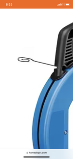

I have a 3/4 run of FMC about 65’ long. The run is pretty straight and flat with only a few gentle bends in it.
It runs through an attic that is not really accessible.
There is an EMT 90 at each end with a FMC to EMT compression fitting.
I have an Ideal Fish Tape that is 125’ with a factory bent end on it that looks like half of an arrow head.
I tried both ends, but can’t get the tape through the pipe. It stops somewhere around the 50’ to 60’ mark.
Is there a better fish tape set up I can use?

Grabbed some Internet pics as I am away from the house.
I should add that I have 2 parallel runs and both have the same issue. This why I am thinking a tool issue over an Install issue.

You can **** it like said above or blow it w/ air compressor
vac / **** works best, tie a plastic bag on a string - the bag needs to not plug the pipe and yet big enough to grab onto the suction…
Will try this one. Did not think of sucking and good info on bag size.

Make sure your flex is pulled halfway tight. 65' of flex isn't going to be great no matter what. If you get it most of the way push another fish tape from the other end, hook the first one and finish pulling it through.
I wouldn't hold my breath on trying to **** a string. Flex is just a spiral of metal, not going to hold air.

Flex in lengths over 50 or so feet can be a *******. I've done the take it apart and put it back together after the wire is in, I know it's a code violation, but there are times when I don't give a flyin' eff. If you have help, the easiest I've found is to have someone shake it while pushing on the fish tape.
This probably won't help with this, more in the future, but cut the end off of the fish tape. About 1-1/2" from the end, heat it up cherry red and bend a new loop in it. Dip it in water to cool it down and tape the gap shut.

The difficulty of fishing flex is why I do not like ENT "smurf tube" either, but vacuum fishing is what got some wire pulled in some Greenfield that a fish tape would not go through.

Flex which is not stretched tight and strapped down while tight is a bear to push the fishtape through. Reason being is that the flex wants to move with the head of the fishtape. Sucking or blowing a baggie tied to mason's twine is the way to go.

Use a fiberglass fish tape- I used one for years on Target store remodels on 3rd shift- also about your only hope with smurf tube- , sometimes folding over a zip tie and creating a loop in front of the fish tape head (wrap the ends of the zip tie to the fish tape end with 33-DO NOT pull the wire in with the zip tie leader! -my apprentice did this once-Bad Spencer!- he learned

As general practice, for FMC, it is easiest to put the conductors into the conduit and then install the conduit, but generally only do this for short runs. When long runs are necessary, I just generally try to avoid FMC and stick to EMT for runs of any kind significant of length because fishing wire in can be a huge pain once the conduit is installed and secured.
Given your installation, I would suggest what others have suggested with sucking in a string line with a baggy (a corner of a grocery bag work GREAT!) and then use the string line to pull your conductors.
Running metal fishtapes can be a huge pain as the leader tends to bind up inside of the FMC. I have had some luck with a fiberglass fishtape, but most of the time look at is pure luck type success.
As a bit of a tip, once you do get a fishtape or pull string through, pull in a spare pull string with your conductors just in case you need to pull any additional conductors into the conduit in the future.
