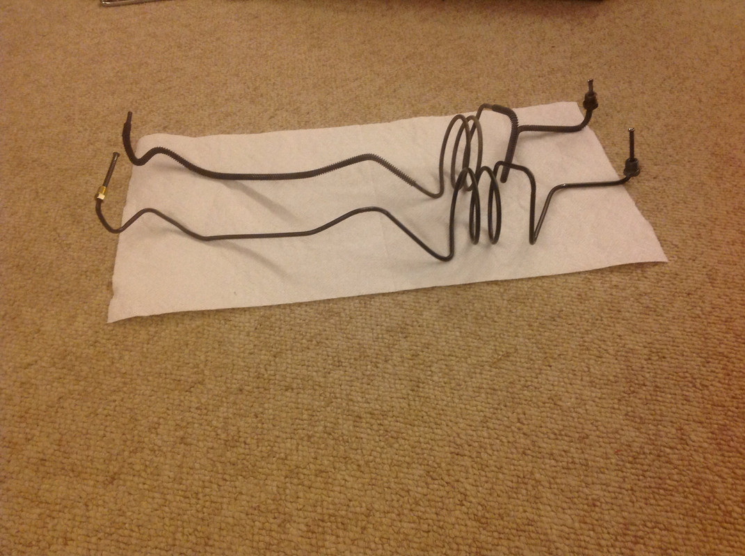

I made all new brake lines for my truck with a cheap kit from Napa. Basically the same clamp down style every cheap name sells.. i just used some vise grips to keep the 2 halves as straight as possible - and it worked.. most of the double flares dont need to be “picture perfect” i found.. the lines are soft enough that once you tighten the fittings down, they will basically bend and shape themselves where they need to be.
This was actually my first ever brake line.. i think i used a bottle and that cheap plier style HF brake line bender to make the shape.. i wound up buying their small handheld line/tubing bender afterwards, and honestly that seems like a much better way to go. Still haven’t used it, but its here if i need it again.

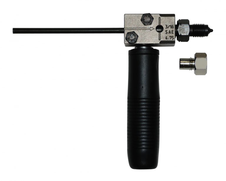

I just did a bunch of brake lines with both bubble and double flares.
My Eastwood tool broke awhile back - the blue clamping arm split open - I gotta call and get that fixed - it's not nearly as efficient with a c-clamp.
The only problem with it is that you have to hold it in a vise. Some of the lines needed to be done under the vehicle.
So I bought a Titan tool - which worked great. It's basically a single clamp block with a handle that clamps with two 10mm bolts. There is a threaded hole on the end. There is a positioner that threads into the hole and sets the position of the tubing before you clamp it down tight. Then there is a double ended forming tool that threads into the tool - op 1 bubbles it and op 2 forms the double flare. The only problem with the Titan is that it only works on a single size of tube.
Thanks for the feedback. I just ordered one of these. Reviews look great. How did it do with bubble flares?
The one I bought looks identical, but is from Cal-Van. Part # 160.
Yeah that looks like the same thing. It doesn't say anything about bubble flares on the package, but it makes very nice bubble flares in the first operation, which is the same thing my eastwood tool does.
They worked on my project on both steel and nicop lines
