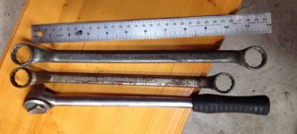

Better late than never. I hope these pictures are good enough to identify these tools. The ratchet doesn't seem like the highest quality item, but its leverage and comfort grip are pretty nice.

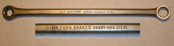

I found this image on Alloy Artifacts of a Duro wrench with "Chrome Vanadium Steel" markings in similar font but I'm not sure that it is significant to your search. Since there are no manufacturer's markings on your wrenches they were probably a lower price contract wrench.
At one time or another, the following (at least) marked their wrenches with the term "Chrome Vanadium Steel":
Barcalo (which is what yours are I believe)
Hinsdale
Indestro
Duro
S-K
16,695
Todd,
I checked all the wrench pictures from the Barcalo shrine and these were the only ones marked "Chrome Vanadium Steel" so I think somebody else may have made them. They look a little like some Thorsen wrenches but I have never seen Thorsen marked exactly like those.
Looks like the ratchet is not marked "USA"--i wonder if this is a later import unrelated to the DBEs?

The other factor to keep in mind is that post-war, as the US mfrs dropped the CV marking from their tools, a ton of imported Japan-Taiwan-China-India etc began to use that same"Chrome Vanadium" device, or CV, or Cr-V, etc. Many of the later ones have no COO mark. If it has some form of the CV marking but no "USA" it's almost certainly a 1950s or later import.

:thumbup: The ratchet certainly is an import and not related.
I'm not arguing, like I said, it doesn't seem of the highest quality, but I have to admit it's much better than the ratchets you find in the old 40pc Taiwanese sets. I could believe it were a low-end USA product; relate-able to to a coarse tooth Craftsman. Anyways, it was included because it came from the same source (yard sale at a graveyard - caretaker passed away and the wife was selling off some tools) and, of course, said "Chrome Vanadium." Not to say that he didn't acquire them separately...
12,078
Probably just coincidental they were together. Dads summed it up pretty well.
I don't want anybody to think I'm ever knocking their stuff by calling it what it is as far as COO. I'm just sharing what I know from years of studying tools. Don't want to see anybody led to believing something is what it isn't. Especially when it comes to ratchets, something I know a good bit about. Or vises, which are questioned almost daily around here.

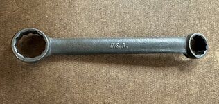

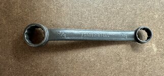

I thought I’d bump this thread and ask a question - any ideas on the manufacturer of this “Forged Steel” USA DBE?

The top one is prewar, the lower probably wartime. You can still see traces of the earlier markings next to the Forged Steel. Definitely Bridgeport.
