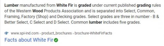

Ard,
Post#12- stated he was quoted Premium Grade #1 White Fir right?
totally my bad- i missed his post #`12
However you will note that what they told him: "premium grade #1 White fir" is NOT a lumber grade from your excerpt. ie white fir is B& Better select or C select or D select. Right? not "Premium grade #1".
Unless they are using a different grading system, other than WWPA.
S4S is 'surfaced' 4 sides. You want this for ALL framing lumber for stick built stuff. S2S is usually rough sawn on the narrow edges. (ie where sheetrock and siding is nailed) Fine for some things, but IMO not a framed, closed building. Also, the dimensions of s4s (in terms of 2x4, 2x6, etc) are all well known and stack up in a known and controlled manner.
Ard, it's very flattering, but don't just go by my little excerpt, as a knowledge base of W.Fir grading by WWPA :beer:. I don't have time to provide full research! Check deeper, the WWPA say they have 5 grades for common White Fir- 1,2,3.........I'll leave it at that, there's some more to it.
