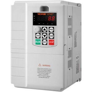

FWIW, if anyone has a 3 phase compressor and only has single phase available, I think I have that sorted with a Variable Frequency Drive (VFD). Let me know if you need any help. Working great now on a pair of 30 amp single phase circuits.
Please do share. Lots of people say it shouldn't be done with the startup loads that a compressor can see, but there are too many people who have successfully done it for me to believe that anymore. Between having a Quincy compressor which doesn't start to compress until the oil pressure in the pump is ~20psi and soft start with a VFD it definitely can be done.

Re: the VFD, there are lots of cheap ones out there. I went with a Vevor unit (link below) that has more capacity than I need just because these things do get worked when they are in use (fans run, etc). I am running a 5HP 3 phase compressor (link below). Note that the VFD will become the switching unit for the compressor motor.
The 220v single phase input wiring is pretty simple. As stated above, you have to run the 3-phase power from the VFD directly to the motor so you will be bypassing the pressure switch controls, safety controls, etc etc on your compressor. I got that working first and could use the run/stop buttons on the VFD to cycle the compressor. Then you connect the control wire circuit on the compressor to a digital switch terminal on the VFD. When you hit the lower pressure limit the VFD will cycle the compressor on, the upper pressure limit will shut it off. This is the simplest part of the setup IMO.
The slightly more complicated stuff is understanding the manual, the menu system and all the settings available. I will be at my shop tomorrow where I can get my reference sheet and post the ones I changed for anyone interested.
There are lots of cool features. One I like is that you can have it slowly ramp up the speed over a user defined period of time, same for the decel. I'm no expert but I *think* this reduces the amount of load on startup. Hopefully this helps.

A few pics of my VFD setup below including the wires from the compressor switches. I used 14-gauge wires from the VFD to the motor. The factory compressor motor wires were 14 gauge or possibly smaller.
For the programmable settings, I only changed ones on pages 11-14 in the manual, but there are tons more you can customize if you know what you are doing (over 50 pages of programmable settings).
Basic settings
P01.02: 2 <--this is what lets the compressor limit switches turn on the VFD power, etc.
P01.08: 60 <--the next three just set the frequency (Hz) to 60, default was 50
P01.10: 60
P01.12: 60
P01.17: 50 <--sets the acceleration time to ~5 seconds
P01.18: 50 <--same for decel time
Motor settings - many of these you can read off the stamped plate on your compressor motor)
P02.01: 4.8 <--motor power in kW
P02.02: 200 <--motor voltage
P02.03: 17.5 <--motor current (amps)
P02.04: 60
P02.05: 3500 <--motor rated rpm
