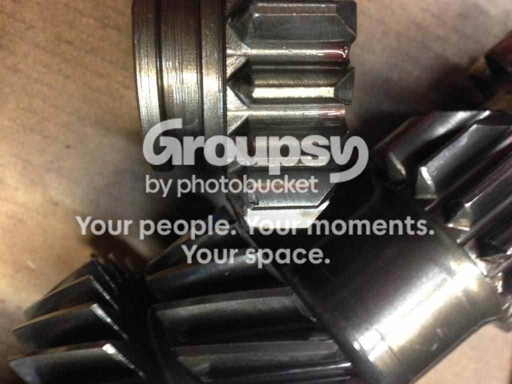

The build engine build took me into September. Somewhere in there I also rebuild a T5 with some new gears and all new bearings and syncros etc. The original gears had been beat on a little bit.
