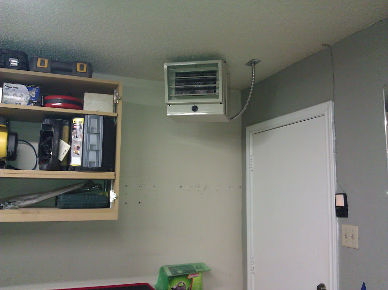

here it is,works great,going to put one on my car side,this one is on my motorcycle side

i am impressed with the heater,with my ceiling fan on to circulate heat,its on low and im comfortable,turn it on high,gets too warm,yes its a g73

its about 10 degrees out today and my g73 is keeping my motorcycle side of my garage(12x24 well insulated 2x6 walls) about 60 degrees on low,uninsulated walk in door.putting one in my car side(24x24 2x4 insulated walls and insulated doors) love working in a warm garage.only thing i dont like about the air and water inc. one is the thermastat is on the back,hard to see....but works great

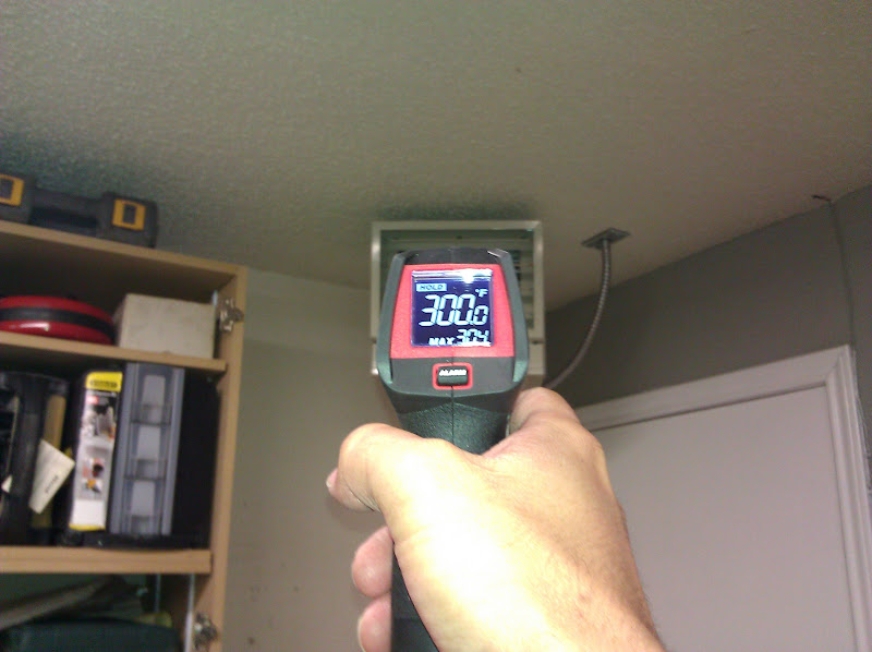

no my element doesent change color when its hot,i keep it on low because on hi it almost cooks you out when your workin
celing fan helps circulate heat

I was just out in my attached garage...the G73 switched on when I walked out. I'm still amazed at how well that little guy works. I keep that garage set at about 50 since I'm not out there...just two cars parked there...but I want to make sure my car washing stuff doesn't freeze.
I don;t remember ever seeing it ever get red or "look" hot..but it pumps heat!
