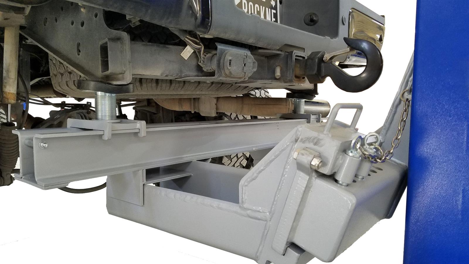

Has anyone ever seen or heard tell of a gantry crane that doubles as a car lift. I'm looking at moveable lift ideas and thought maybe building a gantry crane that would have the same components as a 2 post lift also. When you use the lift either flip up the caster wheels or put legs down for stability. Ceiling clearance isn't an issue but floor space is.

I'm having trouble picturing what you have in mind. For example, a 2 post lift carries load on the columns. A gantry crane carries load on the beam.
What are you proposing?

What type of magic engineering will it take to keep the bottom of your legs from splaying out from the load of the car? I just forsee disaster but maybe I'm missing something.

When lifting a car the frame of the lift would be sitting on the ground not on the dolly wheels. And the beam at the top would be adding support to keep everything square.

So that takes care of sideways movement at the top. But think of a car on a 2 post lift where the lift arms extend inward 1-3ft to contact the car. That leverage would push the bottoms of the posts outward. So how to counteract that? How long will you make the bottom legs so the thing doesn't tip forward or back if you don't get the car CG just right? I am sure this can be done but there is a reason why there is so much emphasis on concrete strength and depth specs as well as fastener specs for a 2 post lift.

A crossmember that connects the bottom can sit on the ground in use so a vehicle can drive over it. The same crossmember can be used to help keep the columns square.
The same consideration goes into the legs of a gantry except that the cg is automatically going to stay between the vertical members since the loss is dangling. For lifting a car, or whatever, on the arms, the legs only have to extend as far as the arms do fore and aft, plus some margin. Heck, make them as long as the potential vehicle if it makes ya feel better, but that's overkill.
